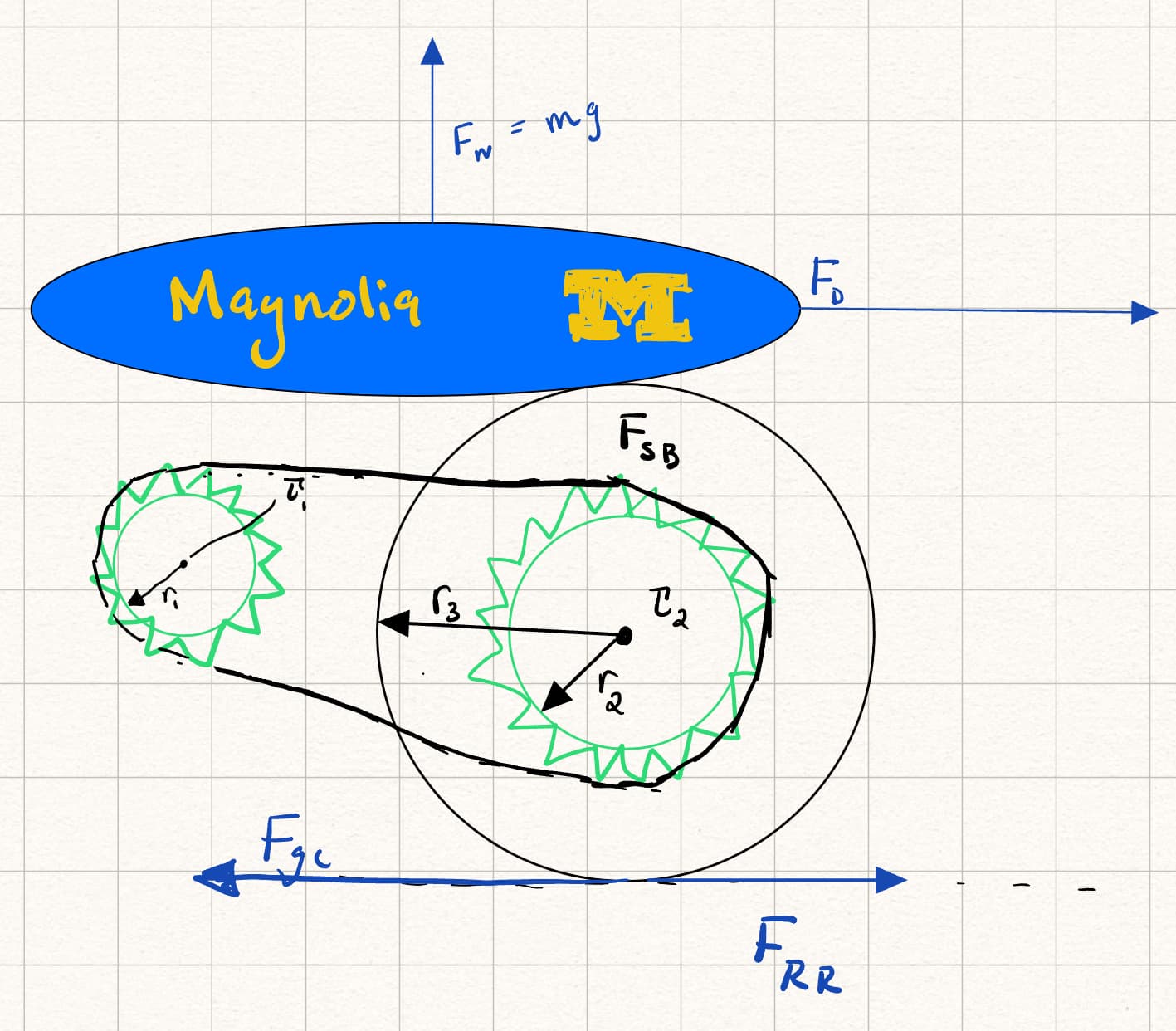

I’ve compiled some MATLAB code to back-calculate the torque we’d need to maintain a 15mph velocity according to vehicle parameters such as gear ratio, coefficient of drag, rolling resistance, etc. Here’s the MATLAB code, and a horribly disproportionate force diagram to go along with it.

I’m pretty sure that this code properly computes the torque that the motor must produce to maintain 15mph. Do you see any issues? With the current numbers, our required torque is 0.2866 N-m. So, I began looking at motor specs to find motors which are most efficient at this torque, with a higher torque capacity to allow us to accelerate up to speed. While looking at motor specs, some datasheets didn’t include raw efficiency, rather a mass-to-power ratio for the motor as specific operating ranges. Do the following calculations look correct for determining efficiency % of the motor from the mass-to-power ratio? Do we need to take into account losses in the ESC during this calculation, so the 44% would be efficiency of motor + ESC? This data seems to be specific to a certain propellor used with the motor. Would this influence our calculations?

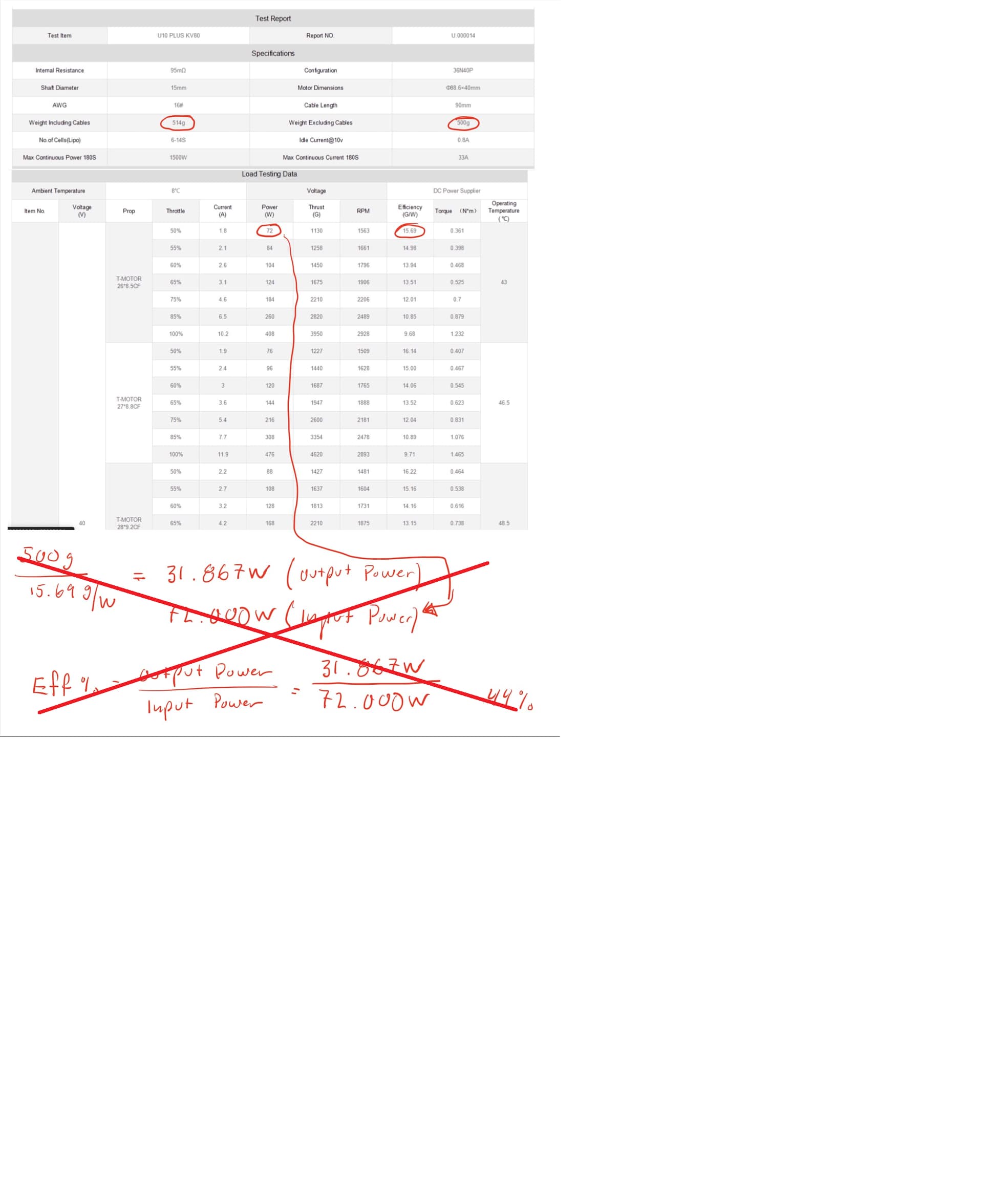

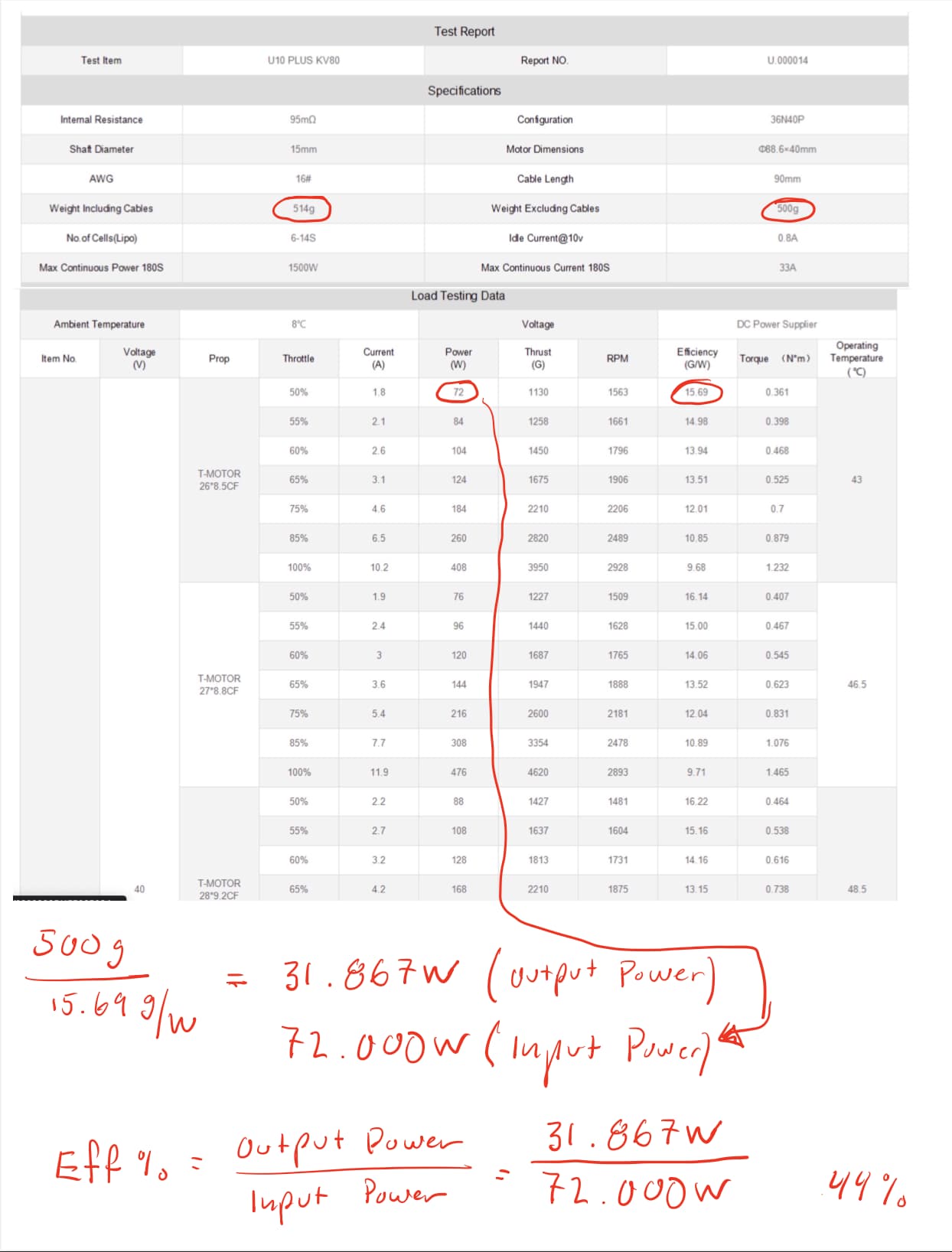

Fundamental assumption error: G/W is the thrust / watt ratio, not motor weight / watt ratio.
The thrust is the propeller vertical aerodynamic thrust, also dependent on the model and type of propeller, so the efficiency listed is irrelevant to your use case. I suggest you use 85% efficiency through-out as a constant.
Let me check the rest. I will post here.
From your rear wheel and gear ratio I get:
265 RPM @ 15 mph
Gear ratio = 9.6
Motor RPM @ 15 mph = 2544
You need a motor that delivers maximum efficiency at 2544 rpm and most efficient at 78W. I calculated from your numbers load of about 72 Watts, using my method, so lets say the truth is around 75 watts.
The torque at 2544 rpm and 75 watts for that system would be 0.28 Nm, so your torque calculation is nearly spot-on, which is excellent.
You need a motor which could produce at least 3000 rpm, preferably 5000 RPM, because motors are usually most efficient in the mid-range of their RPM, and deliver at least about 0.3 Nm at max efficiency. Also it needs to go about 10 times more to accelerate, so max 5000 rpm and 3 Nm.
The motors you showed above are not in that range.
You need a bigger motor.
Most importantly, when calculating efficiency, the rolling resistance at low speeds and laminar flow is about 30/70 so the limiting factor in your system would be the rolling resistance, not transmission + driver efficiency or air drag. You MUST lower the rolling resistance. Also, your rolling resistance of 0.008 is probably a little too high, I would go for 0.005 (or even less, see table below) , which would decrease your wattage to about 50 W and increase the ratio of air drag / RR drag to about 40/60, if you use high quality LRR competition tires. You could get tires down to less than 10W resistance, even down to 7W, which would dramatically improve your efficiency. As you can see, the better tires are more important that a better motor.

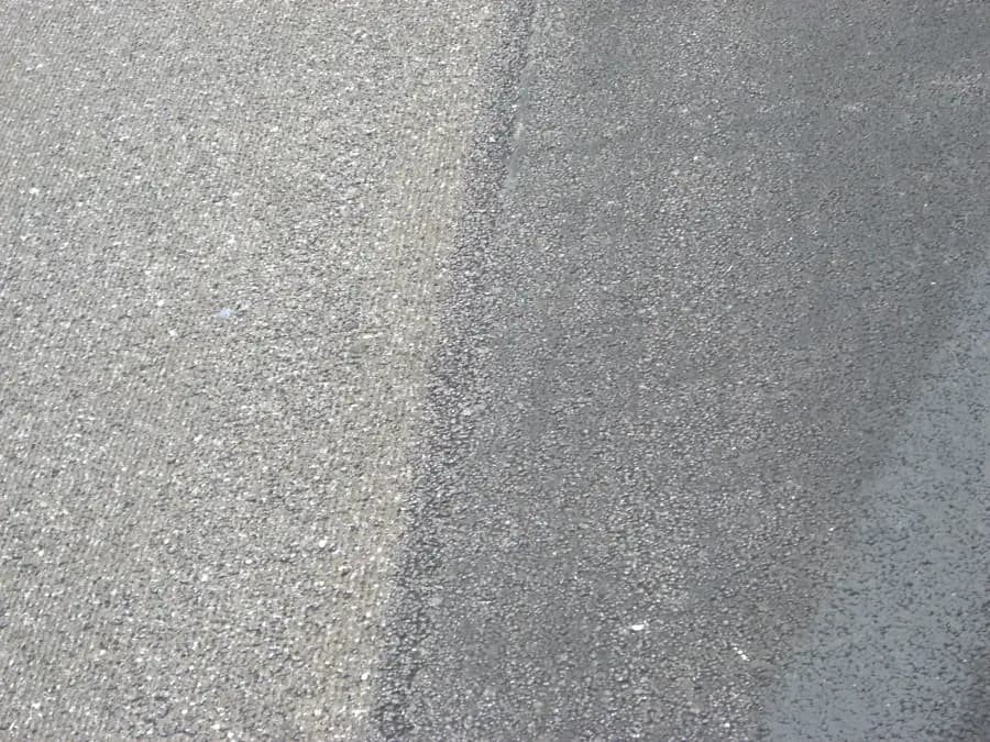

Too complicated I believe. The bad tires will shit on any efficiency gain they get from operating in the most efficient motor region. The rate limiting factor in the overall system is drag and rolling resistance.
My electric car efficiency dropped 10% just because I got new low efficiency tires. I went for high performance track tires, and paid for it. Good grip / fast tires are bad in the efficiency department. But efficient tires ride like rocks, so I figured my ass comfort is more important than my car efficiency.
I got a feeling they could win this if they just attach a $10 hoverboard motor from ebay in the back and get a REALLY good LRR tire to go with it as a direct drive, screw transmissions.
https://www.ebay.com/itm/265859060600?hash=item3de66f5378

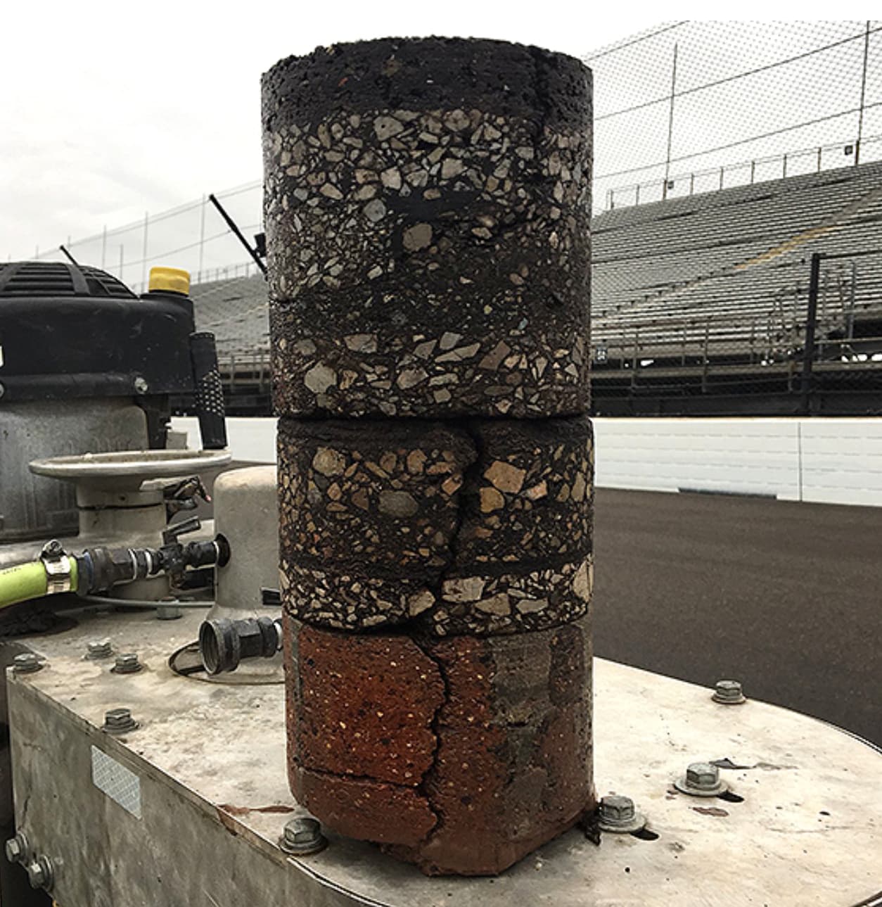

The Indy track looks like that:
It’s diamond ground smooth surface, it rides like a dream. You could ride on a spring-loaded steel rim and get nearly 0 rolling resistance, forget about rubber. I’m even getting a little excited here.

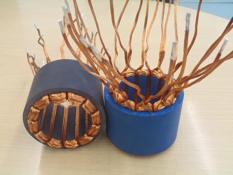

Ok, so they already have this awesome motor/rotor, which by the look of it, can be taken apart for a rewind. At the moment the motor w. a 48v battery is rated for 130Kv x 48v = 6.240 RPMísh. The only problem with it, as for as im told, is that it consumes too much power. Right, so in order to get more torque out of that motor at the needed 2500ish RPM, or lower even w. two-stage-gearing, you got to rewind. Its a simple matter of how strong you are in the electromagnetic force. And that motor they have, is strong in the force. At the moment the motor has 18mOhm internal resistance. Why not make that 0.18ohm?
If its for the larger magnets and you buy a custom wound motor, with a large enough budget, then I get that, but that would be for the magnets themselves, and I would then make sure they are of highest quality/specs.

To go that low you will need Litz wire and up the frequency to 100kHz and more to get full advantage. But then you need to get really high end/quality MOSFETs. You may be asking way too much from college students for a club project.

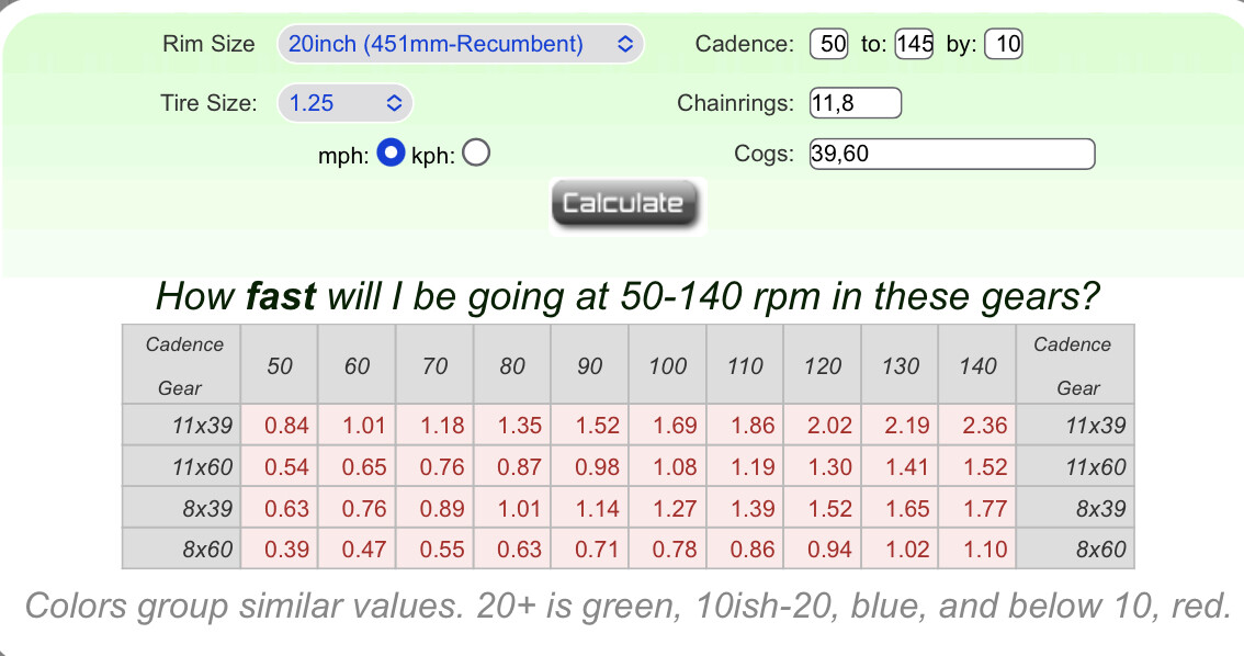

How many teeth are on your motor pulley? Looking online, I see 9t/10t bike chain motor pulleys. Are 8t possible ?
This calculator only does cadence up to 999, so numbers should be x10.
Anyways, as you can see, the 11x60 gearing will not get you up to your desired speed, but the 11x39 will give a top speed of 23.6mph @1400 rpm

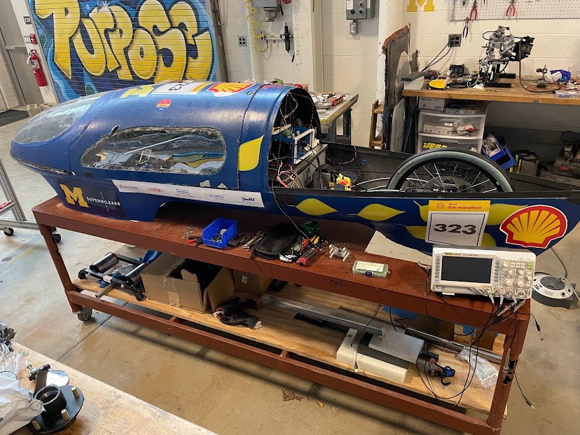

How simple do you think the implementation of a mountain bike gearing system would be? I’ll take some more pictures today of the situation we got going on near the rear wheel to give you a better idea of the space constraints.
Are you sure we can do this? What if there’s an operating range of the motor which is really inefficient? Is there no way to decouple the propellor’s effect to extract motor efficiency from the parameters they give here?
