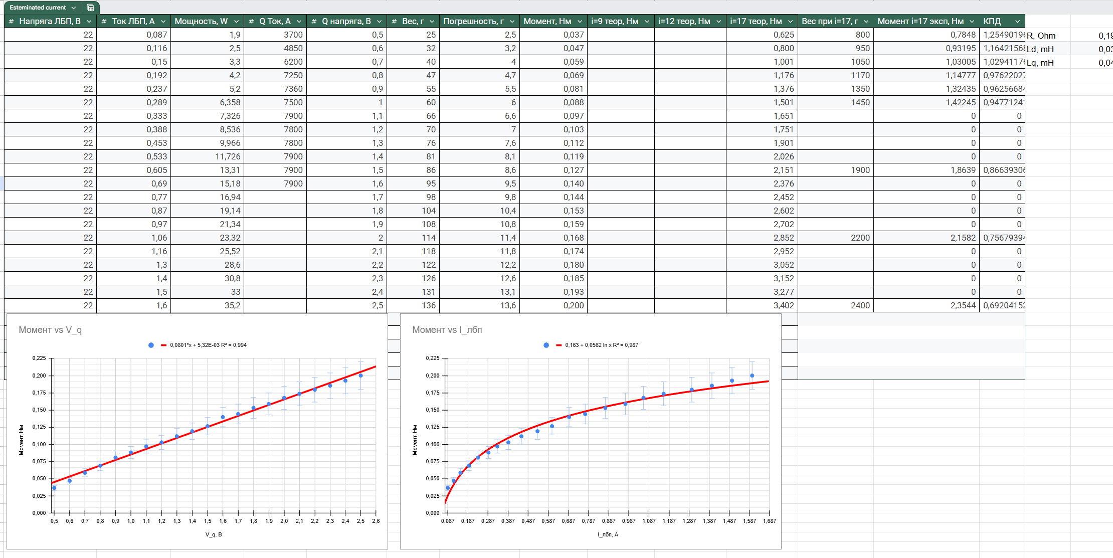

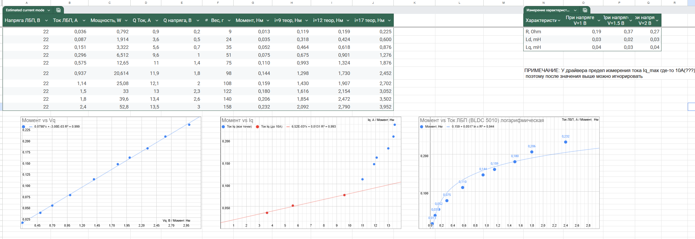

I found a problem that caused me to have a low torque (the current measuring circuit in my driver was weak and did not allow me to see high currents). I switched from foc to estimated current control, and now the moment reaches 2 Nm (and I think this is not the limit, but I’m more afraid to test, suddenly the driver will burn out). The gear ratio is 17. I also measured some of the characteristics of the 5010 in the screenshots (sorry that it’s not in English, but I think it’s not a problem these days), I’ll also attach a video that I recorded last week, this is my extreme progress.

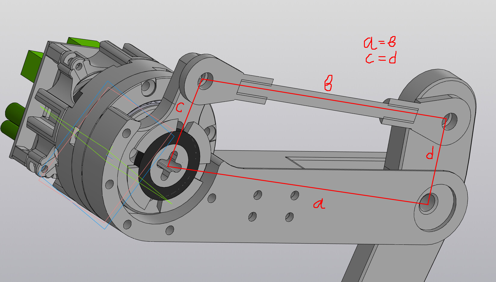

If I understand correctly what you are asking, then we just need to make a parallelogram, then the angle of rotation of the actuator will coincide with the angle of rotation of the ankle.
To be honest, I don’t quite understand what sinusoidal behavior we are talking about, but there were no problems with the torque (well, only maybe a low torque of 2 Nm)
