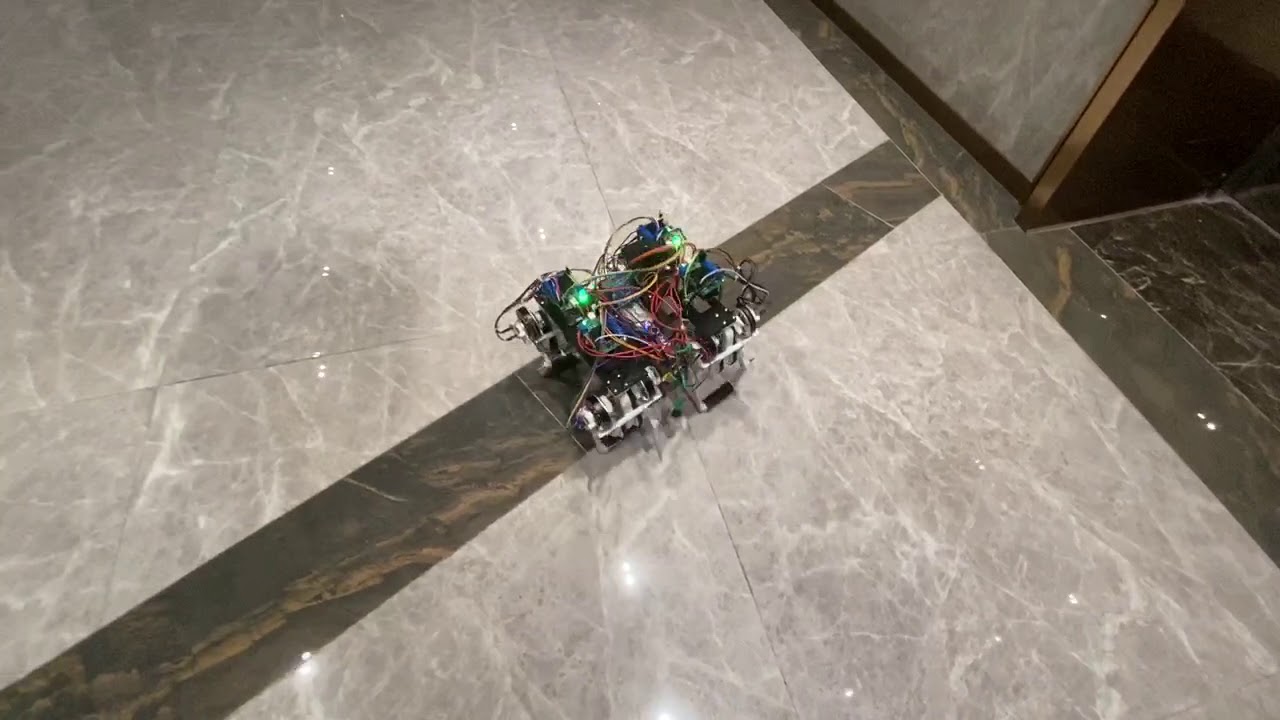

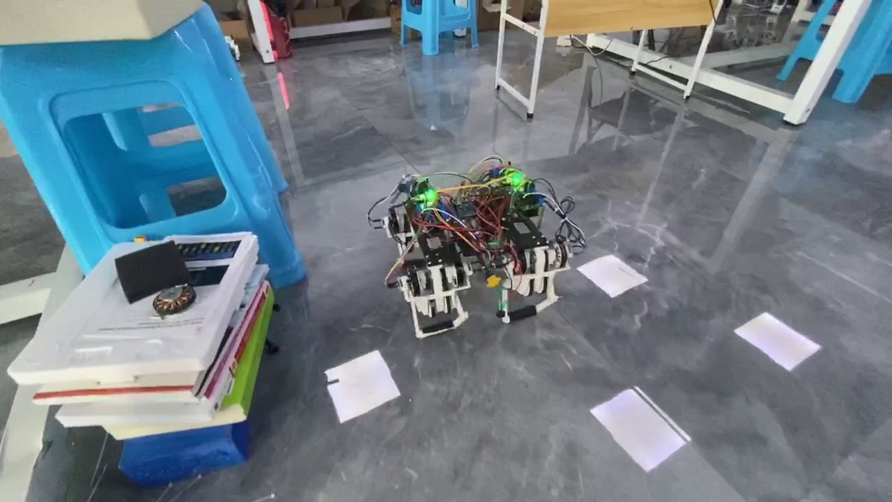

Quadruped robot using simplefoc
Hey guys, I want to introduce the quadruped robot driven by simplefoc. All the schematics will be open source sooner,including the CAD files for the robot , the pcb files for esp32-simplefoc-board (supporting 2 motors) etc.
The results show that simplefoc is good enough to control the four-legged robot.
More videos about the quadruped robot will be available later
