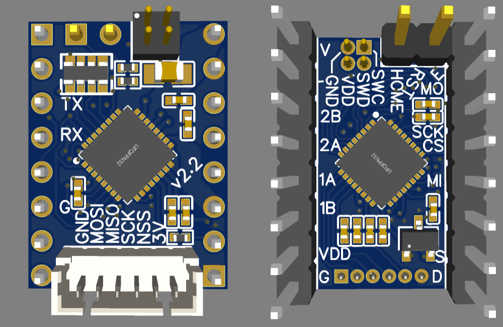

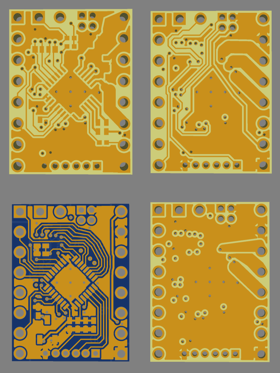

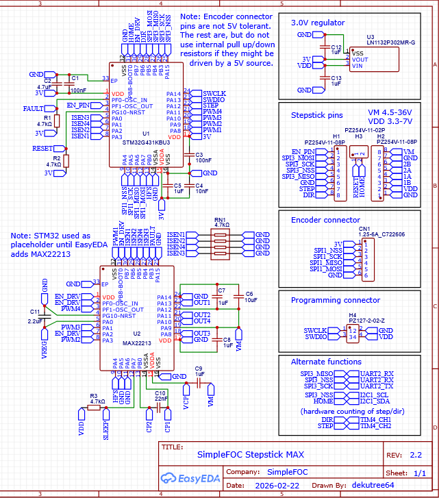

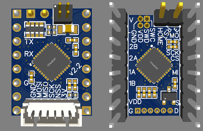

I have to use HybridStepperMotor with 3 channels for now due to my incorrect choice of timer channels (can either use two complementary pairs or three non-complementary channels, whereas StepperMotor needs four non-complementary). I could write some code for the dual complementary stepper scheme I had in mind, but since I only spent a few bucks on bare boards I’ll probably just order the new version I made with the proper arrangement. And the old ones are still perfectly usable for 3-phase brushless motors.
EDIT: I forgot I never actually uploaded the images for the new version.
EDIT2: Updated images after discovering a minor error (had to swap EN_DRV and HOME pins for I2C to work, and add BOOT0 touchpad since it was no longer accessible as a pin).
