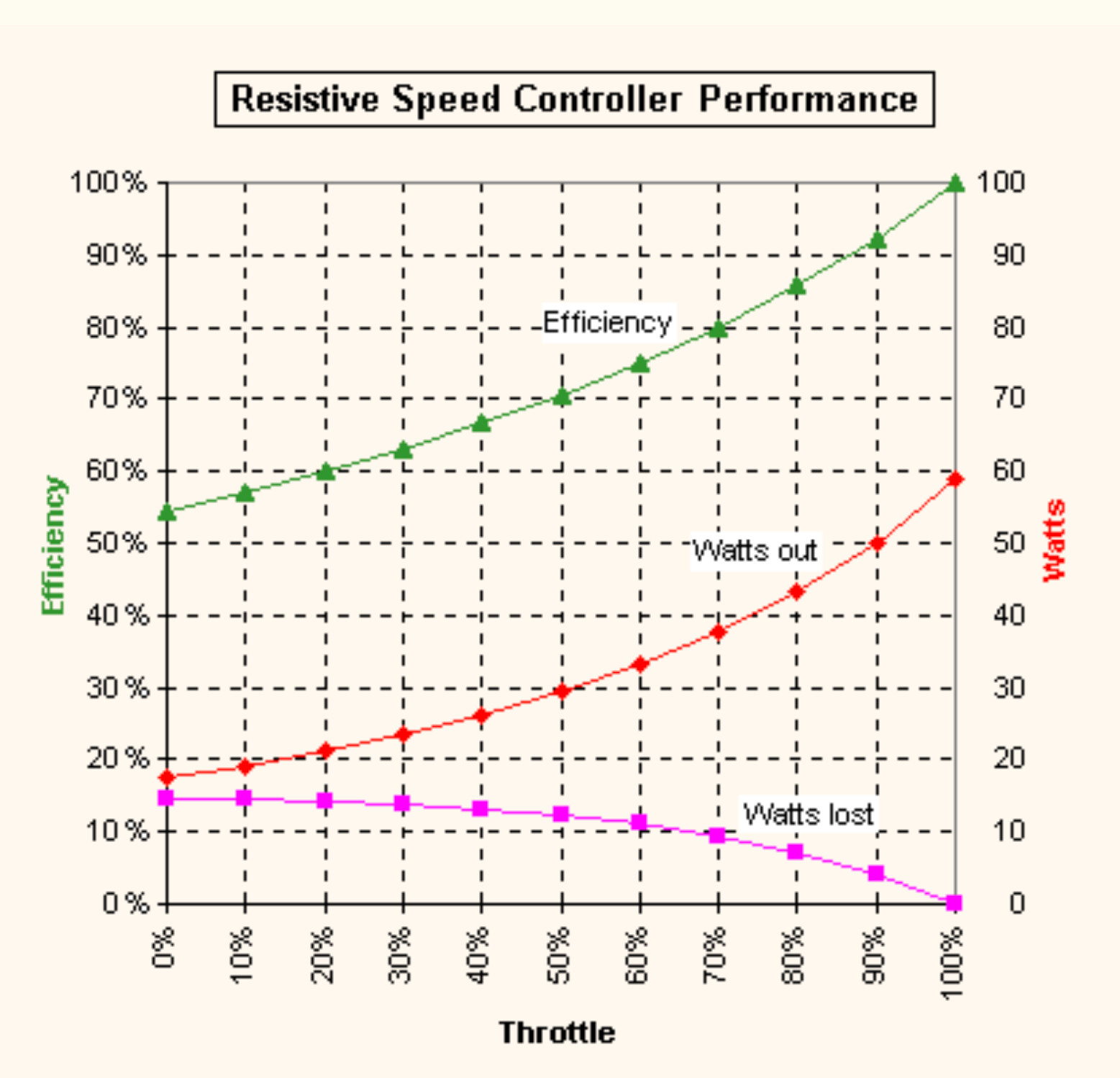

Okay, I’m sure you guys are wondering why we keep asking about high rpm especially in the 300 kV range Most of us are working on long-range drones. The primary reason we keep hounding guys is due to a lack of high-voltage, low-amp ESCs aka, we need to work within the 25v-38v range at 0.5ah-1.5ah there are no esc that work within this range efficiently so due to this, we settle for 20ah esc, which are really inefficient we lose 200-300% because we are only using 5%-15% throttle instead of the normal 20%

Getting to the point of 34 grams per watt = unlimited range overnight solar plane. Now I know i am supposed to lose a bit power with esc but due to the low throttle, i am losing more than I should a lot more refer to image 1
