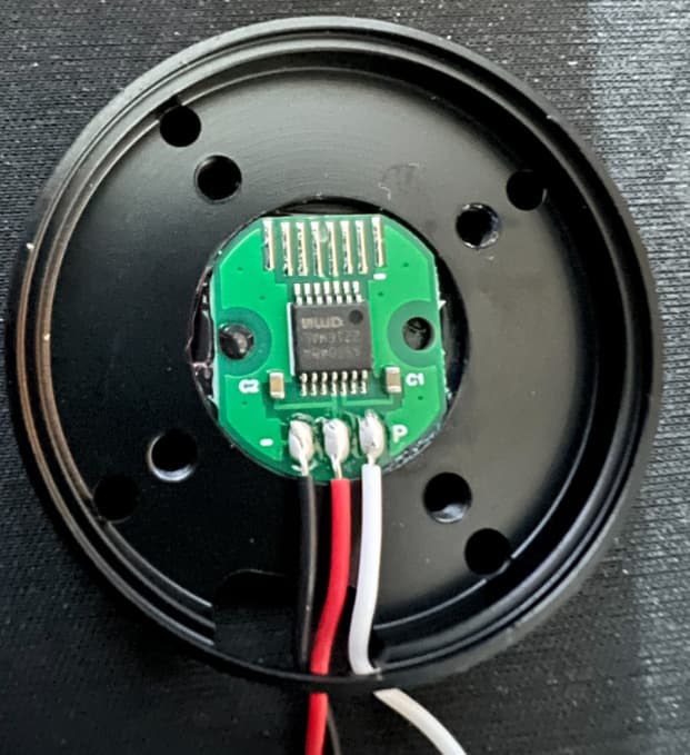

I do have some motors with back cover and encoder that fit perfectly for my use case. I am just not sure of this encoder…is this good? " AS5048A magnetic encoder"
Do you think it is compatible with my controller board?
If you are cv using an encoder and your device is pulled by a string, you have an implicit indicator for your distance to the charger, by simply calculating how much of the string is left on the spool. Detecting the far end is also easy then (position doesn‘t change as expected). This should solve your problem of slowly approaching the docking station.

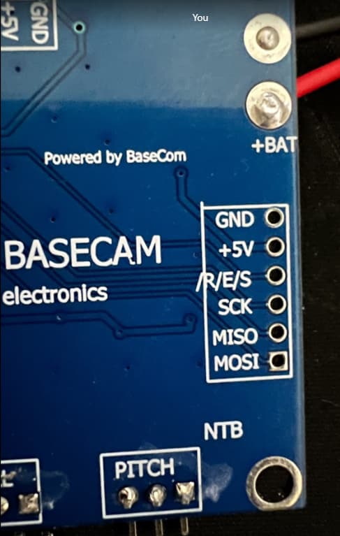

The AS5048A is a good sensor. I can’t tell if your board has an SPI-connector? Something labelled MISO / MOSI ?
The AS5048A is a very good sensor to use with SimpleFOC, but it uses SPI, and I am not sure the SPI pins are available on this board…
Cool. AS5048A it is then. Yes, looks like the SPI pins are available. It has Gnd, 5v, /R/E/S, SCK, Miso and Mosi pins available.
And here is the encoder…what puzzles me is that it has only 3 wires. I read everywhere that an A variant should have 6 wires. I took a close up photo with my phone and it certainly says AS5048A. If 3 is ok, which 3 should i connect here?
