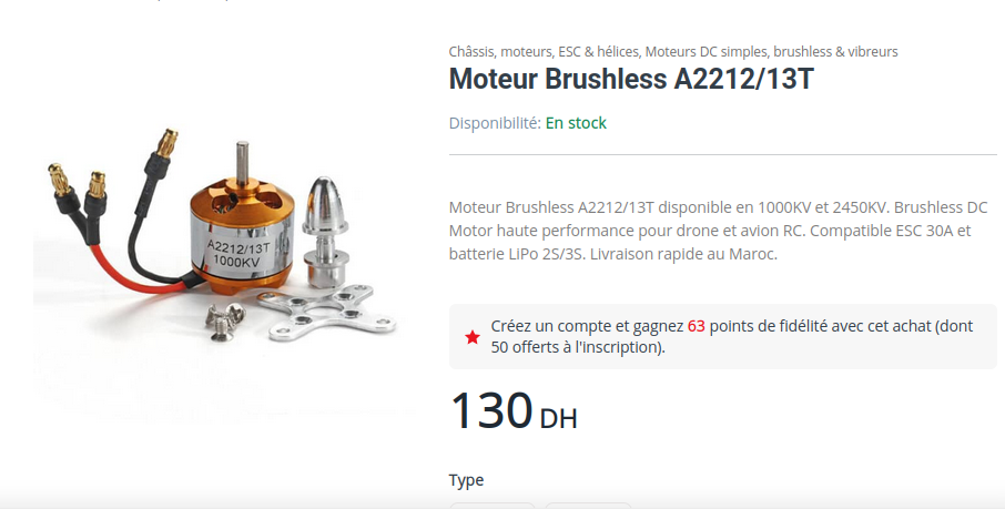

So I have a project on using field-oriented control on a BLDC motor. Looking online the only type of BLDC motor I might be able to buy is: Brushless A2212/13T.
And so I am wondering about which budget-friendly drivers or three-phase inverters that may be compatible with this motor, or if this motor can only be controlled with the already made ESC? Thank you in advance.

I don’t know if there are political restrictions for buying stuff online in Marocco, but you should better look for low-kV gimbal motors, not high-kV motors.
Although there are FOC drivers for such high motor current, their clock rate will not let you run the motor fast enough.
