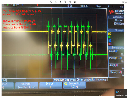

As we can see in the first picture, the angle we get when the motor changed its direction was obviously wrong.

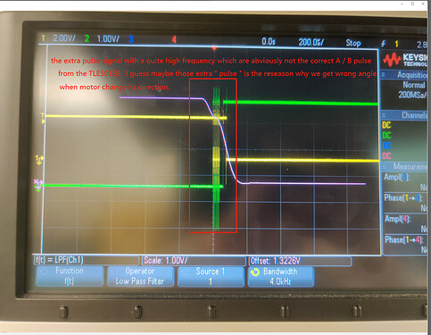

And I try to find the reason for this problem, so I used the oscilloscope to check the A & B single from the TLE5012B.
I find some “extra signals” which shouldn’t exist in the red box ( that noise are quietly similar to the A / B pulse signal but with a quite high frequency)
Besides, those “extra signals” only appear when the direction of motor changed.
I “guess” (not sure) those “extra high-frequency pulse” is the reason why I get a wrong angle when the motor changes its direction.
And I have no idea why these interferences exist.
