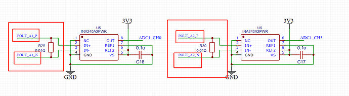

The question about the current sense invert (Phase B)
As author has already mentioned in Simplefoc Docs, the Pins of INA240A2 (Phase B) has been inverted when designing the PCB broad (:Inline Current Sense | Arduino-FOC).
So the current sense of Phase B should be written as
// inverse current sensing gain on phase b
current_sense.gain_b *= -1;
When I was drawing the PCB Broad, I restored this connection ( I inverted the " inverted connection" of phase B.
However, I have not found the related setting in the library of Simplefoc Arduino source code.
So I want to ask if I need to modify the relevant code (Phase B) when I use the modified circuit board.
