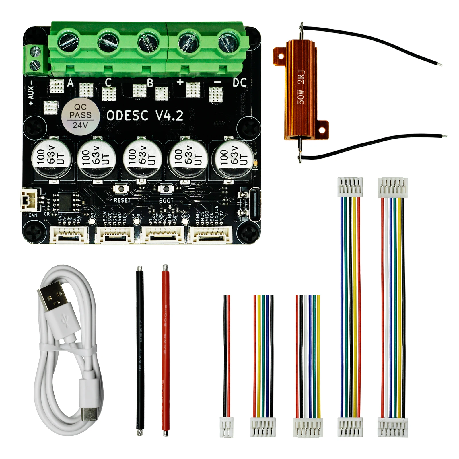

Hello,
I’ll probably order one to test it with Chinese Odrive 3.6 controllers that are compatible with simpleFOC.
With an 8:1 reducer, it shouldn’t strain, and it’s all-aluminum construction, I think.
https://fr.aliexpress.com/item/1005006314725836.html
Since you can also buy it with a driver included it might be worth looking into the integrated package. I just emailed Steadywin asking for documentation on the driver.
Steadywin provided me a copy of the manual in Chinese. Here’s a link to a version I ran through Google Translate. The Images with text didn’t get translated so I made modified the motor characteristics chart to translate it. https://drive.google.com/file/d/1DNvFJ1lQR4EmVzGjNB85w2pVHRir4s9p/view?usp=sharing
Based on the datasheet it looks like the optional driver uses Odrive 3.6 as well. $20 extra for the driver included seems like a good deal and it’s nice and compact integrated with the motor housing.
thank you :clap:
did you try asking him for the driver schematics?
Pages 8 - 13 of the doc I posted have the driver board layout and schematic for the expansion header.
@AZSupra the docs are very good. The board layout/pins look good too. But I don’t think anyone will ever get simplefoc running on it. It uses a n32g455rel7 from nations technologies. Can’t find an Arduino core that supports that manufacturer. It is possible that this is a super close clone to an stmf4 or stm32g4 but the part number isn’t an obvious match.
So I’d treat this actuator as a closed firmware odrive clone. They provide the examples of how to use odrive client software to control the board (usb or CAN). The x0812fvs connector you pointed out has pwm in / direction but that is i think undocumented.
So in summary an odrive clone that could be very useful for many robotics projects but unlikely to have replaceable firmware.
The xioami cybergear in comparison has a gd32 chips which makes a simplefoc port possible. I prefer the extensibility of steadywin board so a bit of a shame about the n32 choice
I agree. They are both in the same price range anyway.
I don’t remember the motor specs of the cyberdog motor, but max. 60% efficiency seen in the SteadyWin-papers aren’t exactly a winner IMHO.
