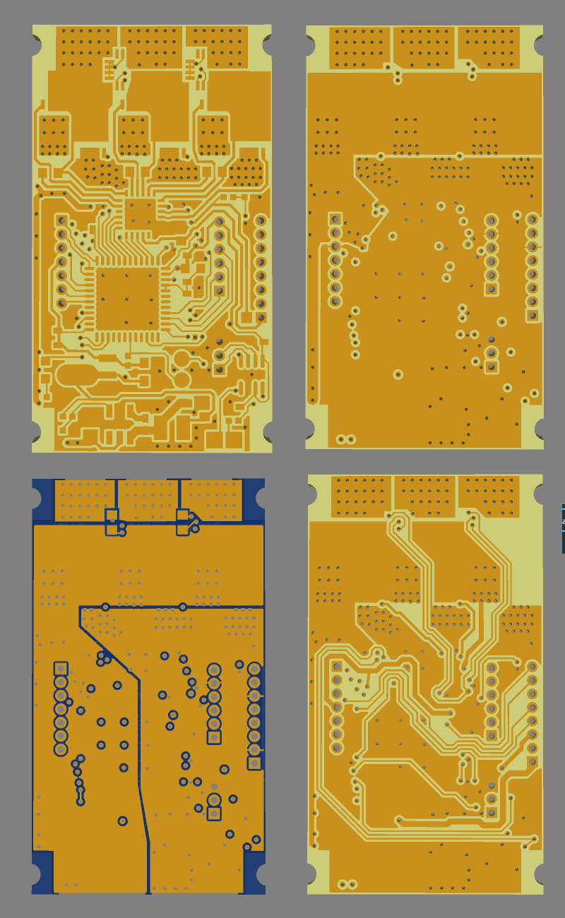

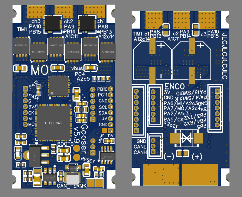

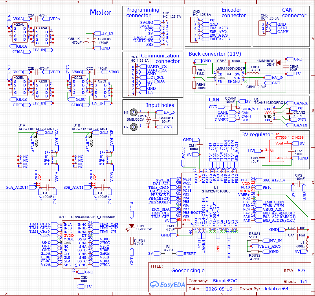

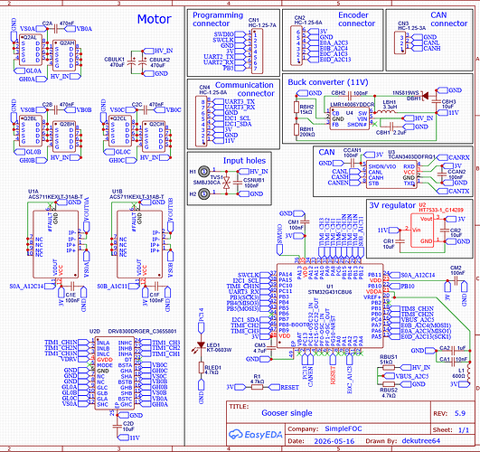

The latest version of my Gooser is not fully validated yet, but it’s good for medium sized motors. No CAN bus since that’s mainly for communicating with drivers that are located near each motor, whereas the primary dual/quad design of Gooser favors having the drivers near the battery. But I have considered adding it to the single-motor version since it’s pretty heavily modified already and can spare the second encoder connector for it.
EDIT: Annnd here it is. 6 hours, I’m getting faster :slight_smile: I didn’t even have to increase the board size, just move the mounting screw holes. Less GPIO than before, but still plenty, and the encoder is upgraded to 6-pin so it can do SPI without any hassle.
