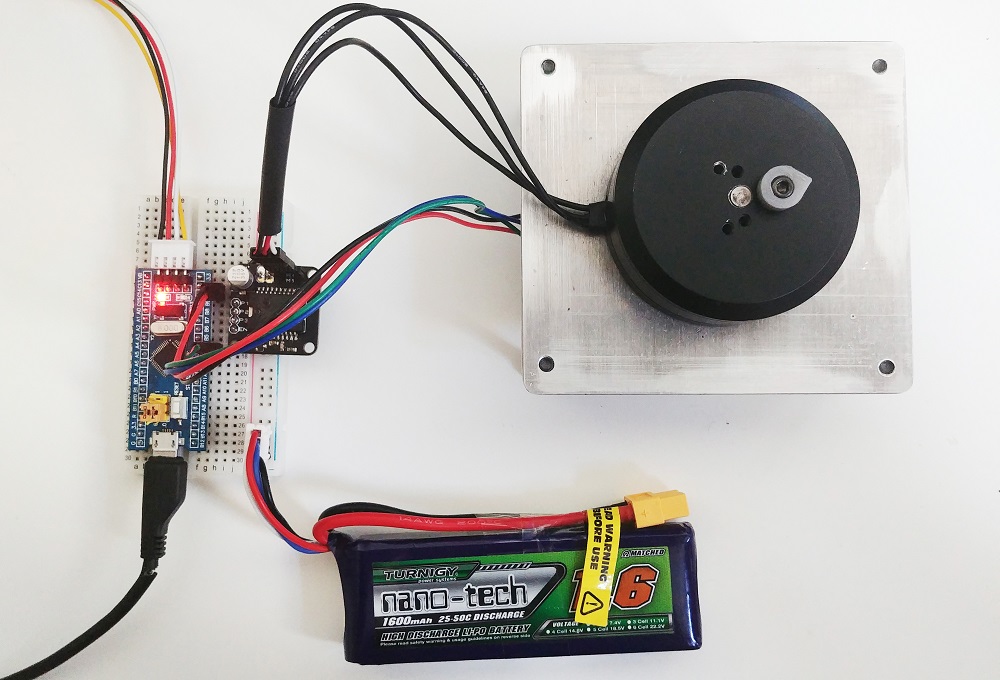

I am in the middle of implementing the SimpleFOClibrary for Stm32 boards. Even before I am finished with it I wanted to release you give you some updates about what can you expect form it and it would be very cool to have some feedback from you guys!
I am primarily testing the code on Bluepill board and Nucleo64 stm32f401re, but most of the nucleo and bluepill boards are the same and you should have no problems running the library with them.
You will be able to use the the same Arduino IDE to upload the code. The sketch code and all the library features will stay the same, basically you will be able to upload your Arduino UNO, change the board type in the Arudino IDE, change the serial port and upload your Nucleo board directly.

Hardware setup
Here are some photos of my setups:
