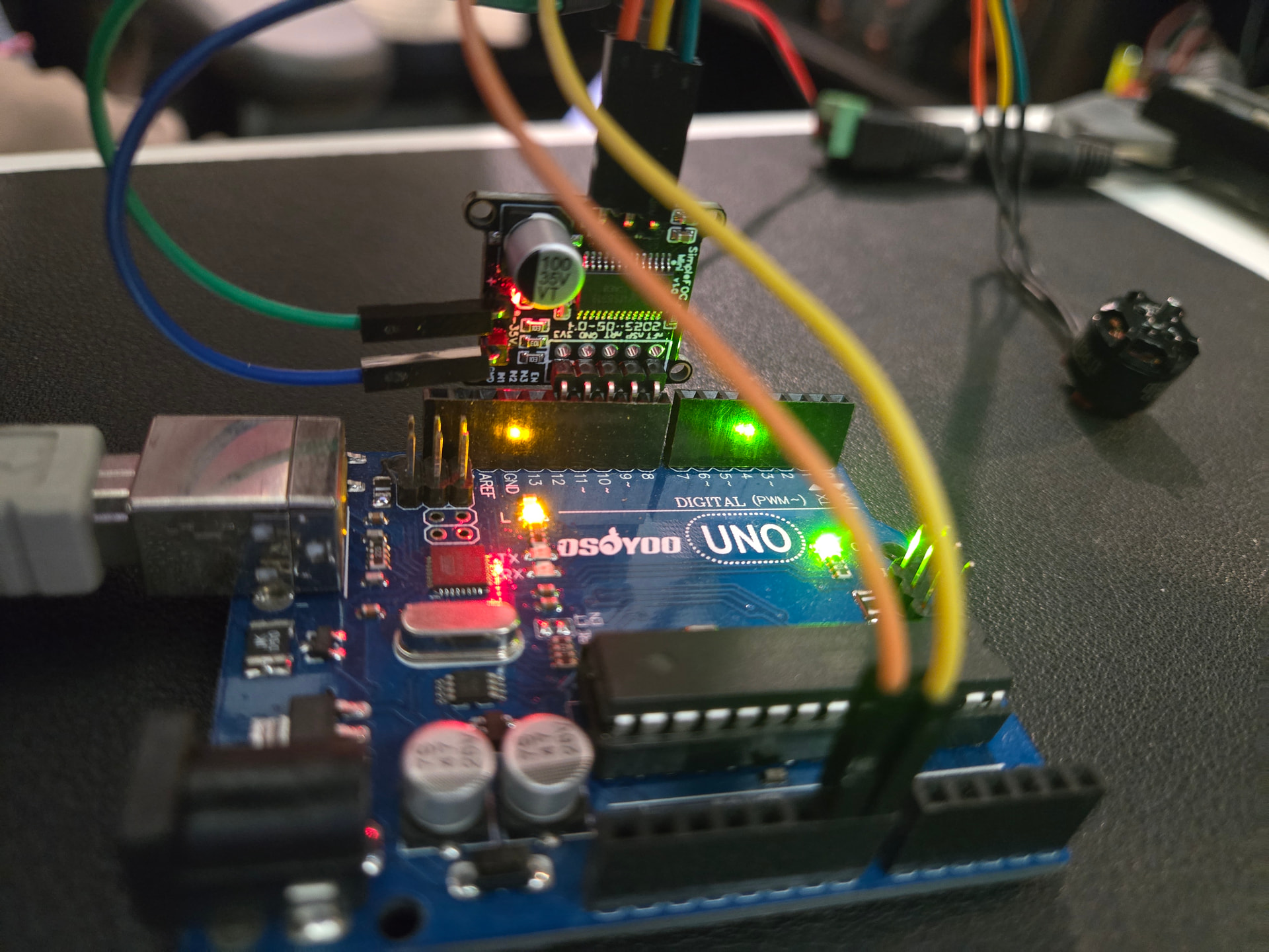

Motor shows no signs of life. Driver doesn’t heat up.

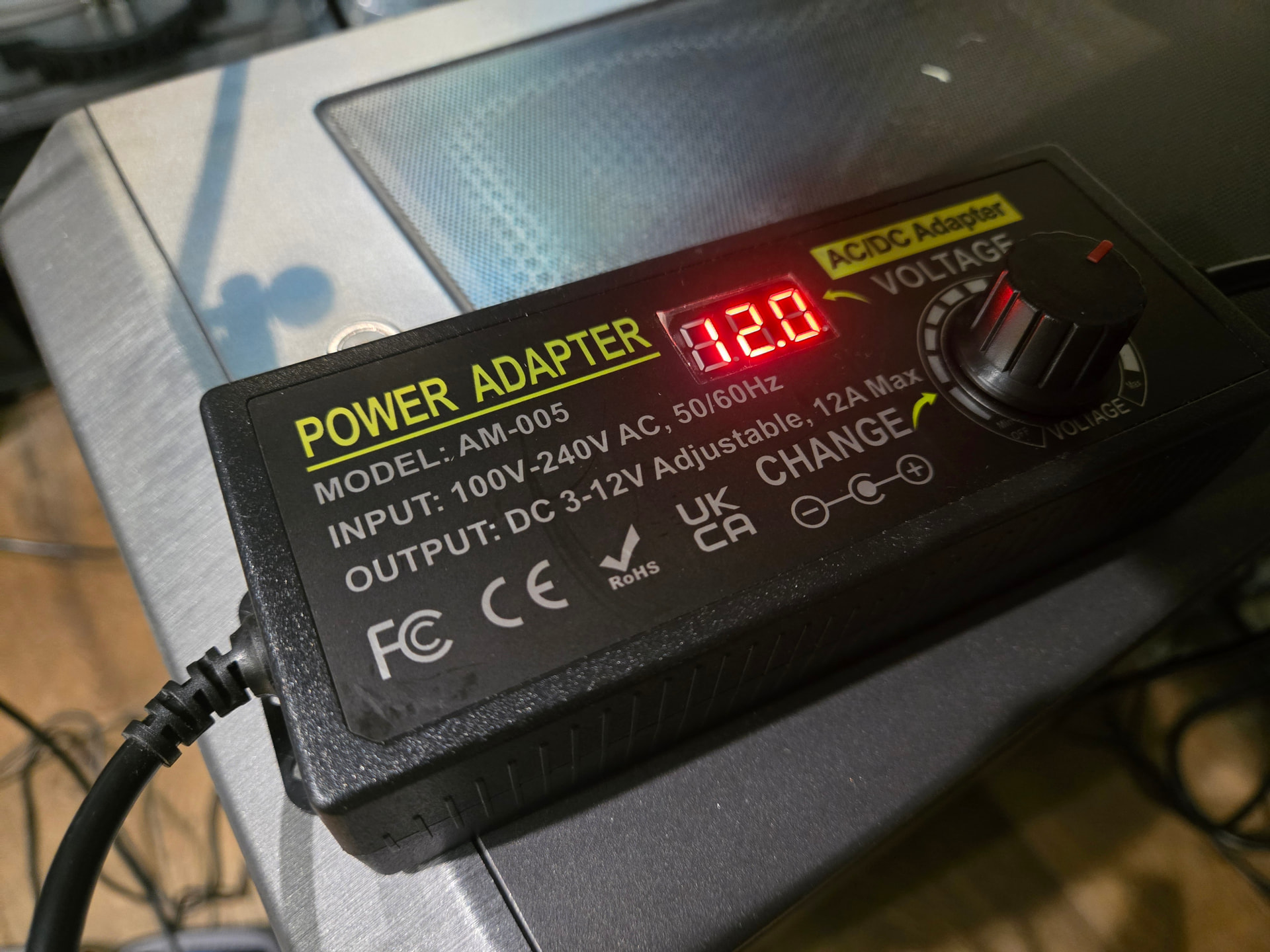

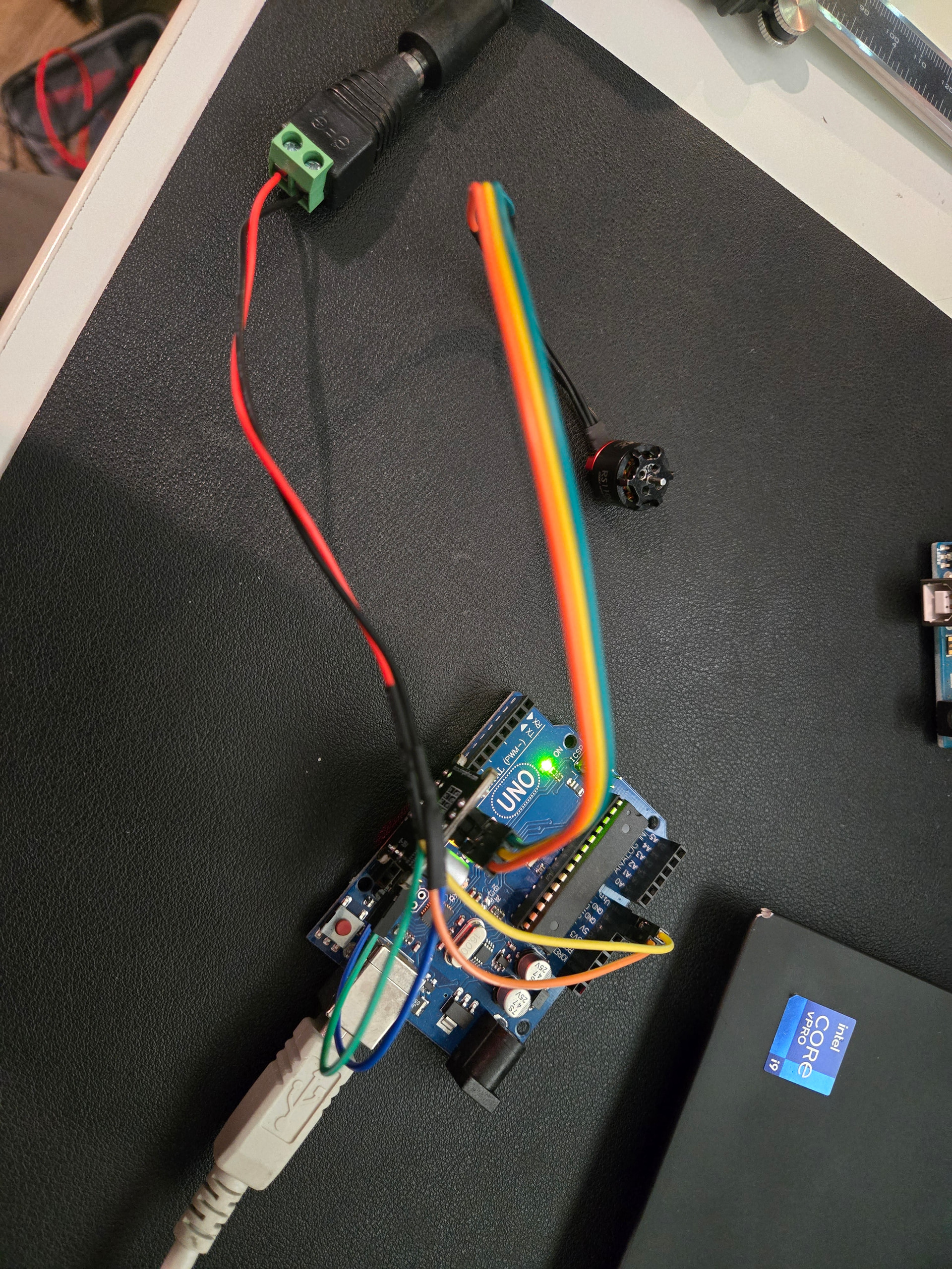

I’ve tried running the motor in open loop mode just to see if the controller is working (script attached below). The motor is a 6000kv 6 pole motor, about 1.5 ohms resistance. Power supply is 12V 12A. I’ve tripled checked the wiring and measured all the enable/fault pins and all seems nominal.

Sorry, figured out the issue. It was a current limiting issue. The motor at 12V pulls too much on startup and instantly puts the driver into overcurrent protection. At 9V it’s working and with a different motor with 3.5Ohm it works at 12v.
Glad you got it figured out. Assuming you’re using the latest SimpleFOC, you need to set motor.torque_controller = TorqueControlType::estimated_current; for it to calculate current from resistance. Voltage mode used to change behavior depending on whether resistance was specified, which was always a little confusing. Now it’s confusing in a different way, needing to know which version of the library you’re using, but I think it’s better in the long run.
