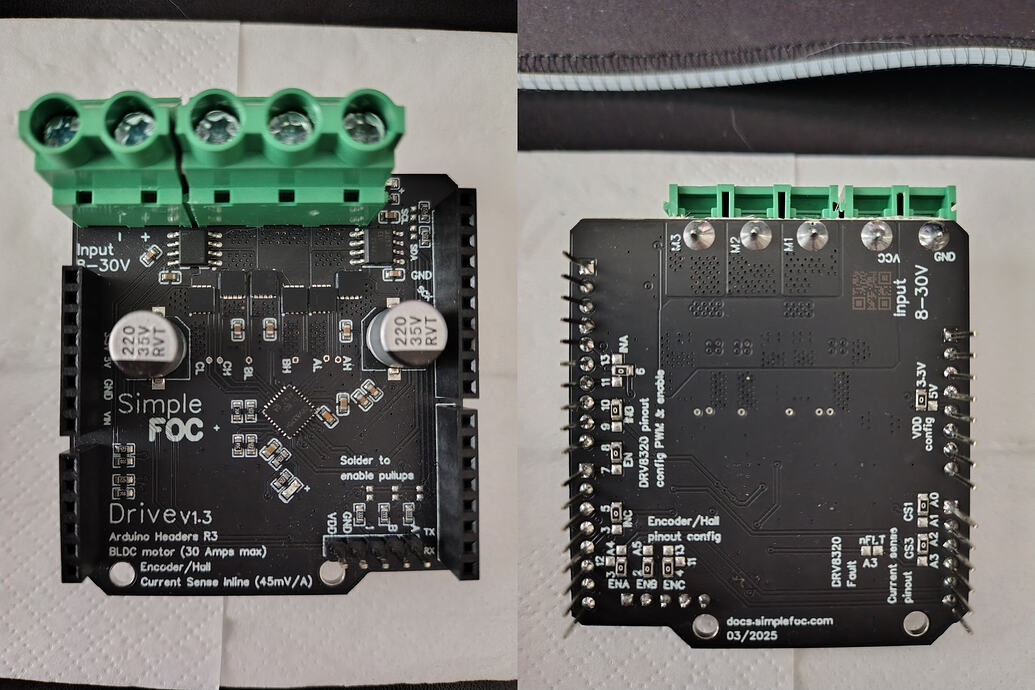

Hello everyone,
For a few days now, I’ve been trying to successfully start closed-loop control on my SimpleFOC Drive v1.3. I initially tried with an Arduino Uno, and now I’ve migrated to an STM32 Blackpill (F411CE), but I am hitting the exact same problem on both MCUs.
My Hardware Setup:
  • MCU: STM32 Blackpill (STM32F411CE) / previously Arduino Uno
  • Driver: SimpleFOC Drive v1.3
  • Motor: 5010 360KV (14 magnets, 12 coils → exactly 7 pole pairs)
  • Encoder: AS5600 via I2C
  • Power: 4S Li-Ion pack (16.8V)
The Problem: When running in closed-loop velocity control, the motor moves smoothly during the calibration sequence (a little left, then right). However, right after that, the pole pair check fails (estimating ~14 or 6 instead of 7), and the motor either starts shaking aggressively or locks completely in place (the shaft becomes rigid).
This happens whether current sensing is enabled or disabled. Here is the output from the Serial Monitor when running without current sensing:

According to your PCB solder bridges the PWM pins are (6,10,5,8) = (A,B,C,EN)
Does that match the Blackpill pins you are using : BLDCDriver3PWM(PA8, PA9, PA10, PB12)
And what about the I2C pullups? I don’t see them soldered, although you mentioned it works.
The PCB is just the example of the board i have. I changed 0 ohm resistor and as I said in older version it works in open loop (2.0.0) and in the new one it spins during calibration and then stops or starts shaking. I didnt solder pullups because I use A4 and A5 pins on arduino for SDA SCL (B6 B7 on stm).
