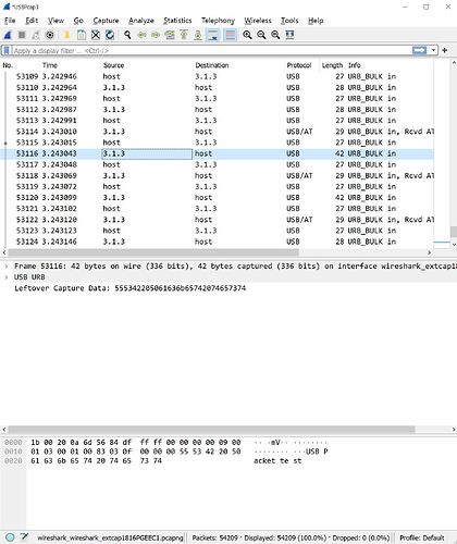

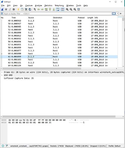

Ok, I see the USB message is broken down into separate chars. Each USB package has just one character. That is a lot of packages to send.

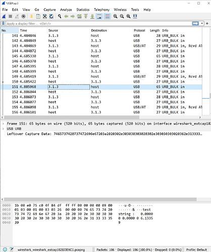

I can confirm, writing a string to simpleFoCStudio does not work… Cant test properly at this moment, but i can see the data coming through in one single packet.

I just ran a test using the motor.monitor(); function vs. writing a string via USB to FoCStudio. Turns out the motor.monitor(); is significantly slower, compared to sending a string each 2 milliseconds. I think it has to do with the USB protocol doing excessive handshaking.
this is using motor.monitor();
This is sending a string each 2 millisecond’s
