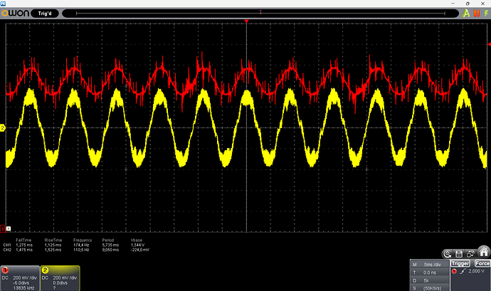

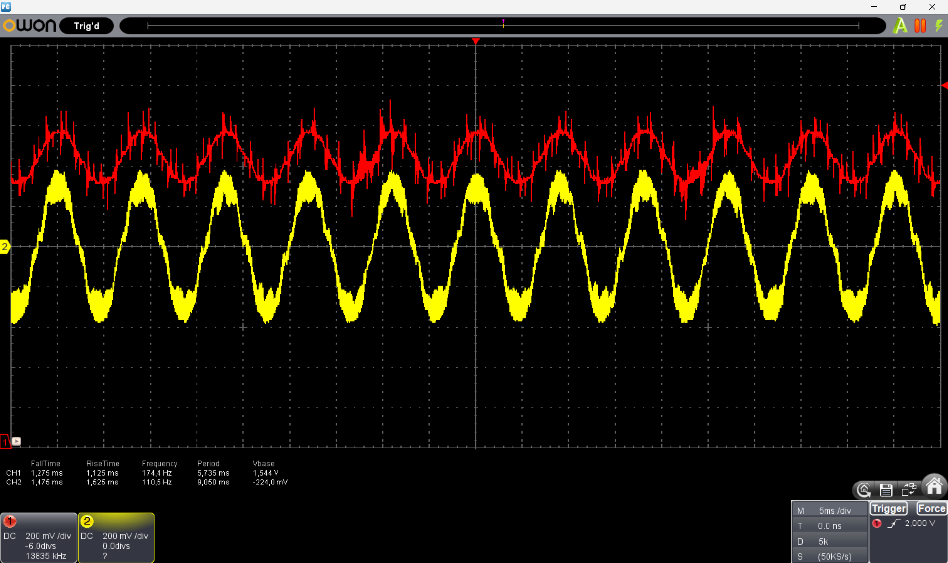

I’m working on a custom board with an STM32G4 and a 7‑cell Li‑ion setup to drive a motor using sensorless FOC. My phase‑current waveform is not clean — instead of a smooth sinusoidal shape, I’m seeing spikes in the phase current.
  • Yellow trace: real phase‑current measurement from the current probe
  • Red trace: DAC output of my phase current Ia

Question:
What could be the reason for the spikes?
My intention is to solve the root cause.
