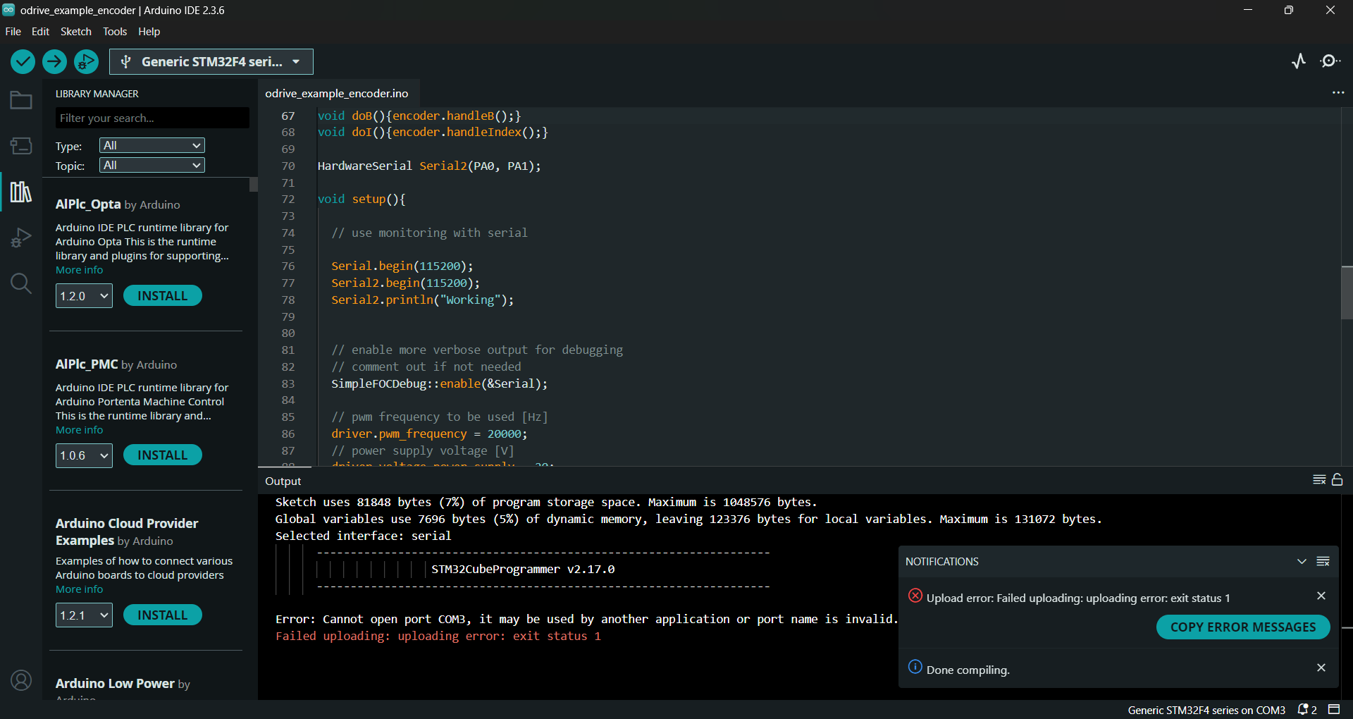

I was able to compile and upload the code using an ST link but I’m not sure on how to print data to the serial monitor for debugging.
The o-drive comes with an usb port which I tried connecting, with no luck of it being detected as a port in the device manager. Can someone kindly point out what should be done differently.
Thanks.
arduino ide setup for reference:

How is this USB port connected on the hardware? Is it connected to the STM32 chip, or is it just for providing power? Or is it connected to a serial converter chip, maybe?
If its connected directly to the STM32, then the settings you show are actually correct - CDC supersedes UART means you should be able to use the USB serial on the “Serial” object in Arduino.
Did you open it with Serial.begin() ?

I can’t say what’s usual for ODrive but it sounds like the virtual com port you’re seeing is the one from the STLink. The STLink integrates a VCP, which is different from the one you can activate on the STM32s USB port…

Looks like you have a different kind of problem, it’s not finding the COM port you have chosen at all…
These kind of problems are common… before trying to program anything or connect to any serial port, make sure you can see the devices in the device manager and USB devices list, make sure you have all required drivers installed, etc.
