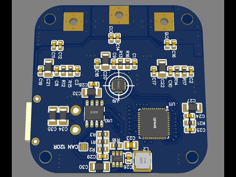

Hi, a few weeks ago I made a driver board based on the IFX007T.
Here’s a quick video of me taking it for a spin:
(this is just with a 2A 12v power supply)
Here is the schematic, PCB and 3d model for the test mount:
And this is the project that I’ve flashed to the board:
https://github.com/jkirsons/BLDC-Driver-IFX007T
Note: I’m not an electrical engineer (I’m a software developer) - this was just put together from datasheets.
This is my first PCB with SMD components - I ordered the PCB and stencil, and got a $30 hot air gun from aliexpress. I was surprised that my first revision worked!

Very nice project :slight_smile: Could you tell which engine you are using?
Thanks. It’s a Gartt ML 5010
https://www.aliexpress.com/item/32517972556.html
I think it has a bit of cogging - in the video you can hear that in some positions it has to put in a bit of effort to keep it at that spot.
