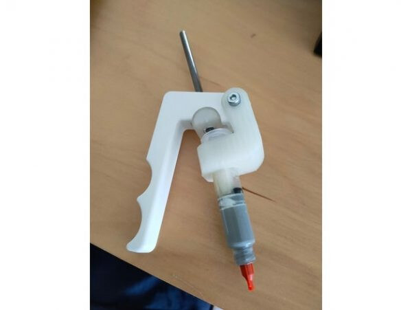

Hot plate, hot airgun, low temp solder paste and squeeze the solder on the footprint with a syringe and appropriate needle gauge. If your eye to hand coordination is good, magnifying glass goggles, pinpoint soldering iron and bismuth solder.
