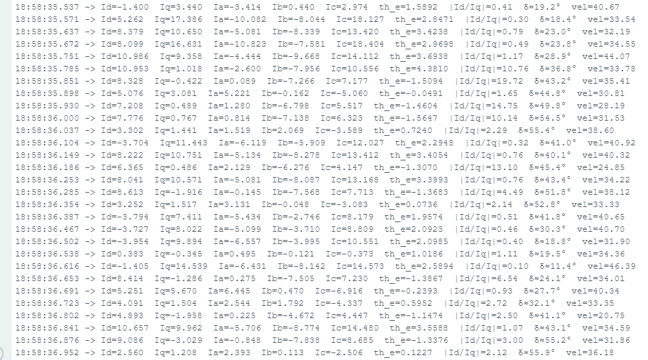

I have shunt resistors and the values are this when I put T2 in voltage control.
So, I don’t know that’s “normal” or I have problems in the hardware or the code, thx.
