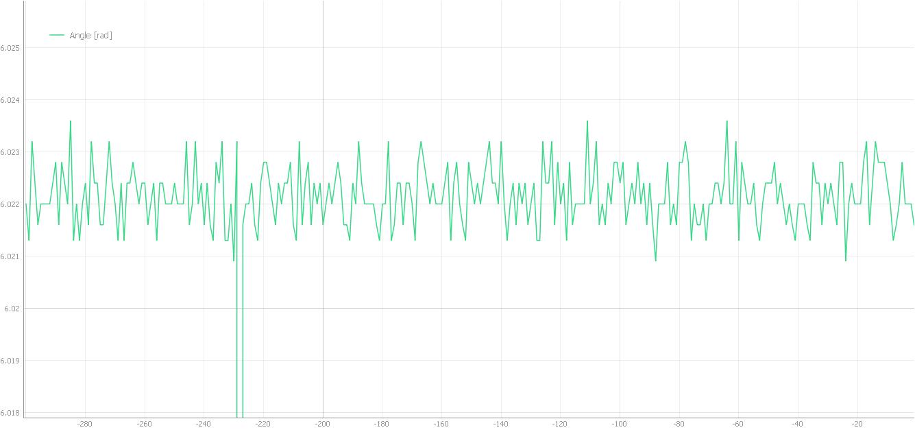

My main issue is in the AS5048A giving a lot of noise in the measurements, which causes the velocity measurement to jump up and down quite significantly. I am trying to understand if this kind of jitter is to be expected for this encoder and if going to something with more resolution (MT6835 - 21 bit) will help with the noise/jitter in the measurement
The value sometimes jumps to 0 periodically (you can see the out-of-range peak in the plot).
What can I do to improve the baseline reading for the sensor before applying filters?
My ideal scenario is to be able to get repeatable and accurate measurements in the 14-bit range. Ideally, I want to try using magnetic encoders first before giving up and moving on to other types of sensors.

That is a real issue. This will probably electrical problems of some kind rendering this reading incorrect. I think you have to solve these or you’ll have problems…
The other jitter looks like 1-2 LSB of noise, this is normal for the magnetic sensors. There is a PR in our repository which attempts to address this issue. You could also try with filtering or hysteresis. It tends to be less of an issue when the motor is actually moving but it’s a know problem…
