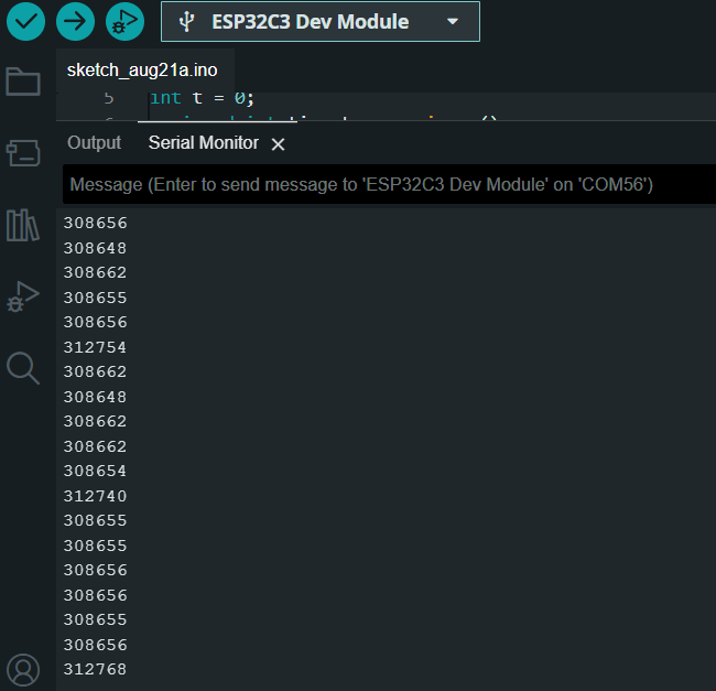

I would like to know what is the elapsed time of analogRead on that board.
So if someone could let me know what would be the output of this code that would be very very helpful.

I only have Esp32C3 Supermini.
Does that help?
Hey @2hry,
That’s exactly what I was searching for. Yeah it’s around 30us per call. That’s a lot.
