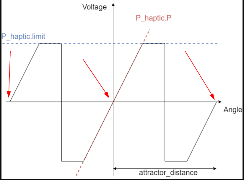

Its the current motor’s shaft angle where the motor will be attracted to.
The arrows show different attractor angles on the plot from before.
Thx @Antun_Skuric
I am still a little unsure how it works. Can you explain it a little deeper for me? Has it something to do with at what point the motor will go from repel to attract on the points?
I saw that you wrote somewhere that the point was is the middle. What if I want the point to be after like 80/20? So when the motor is 80% on the way to the point, it snaps the last 20 %?
