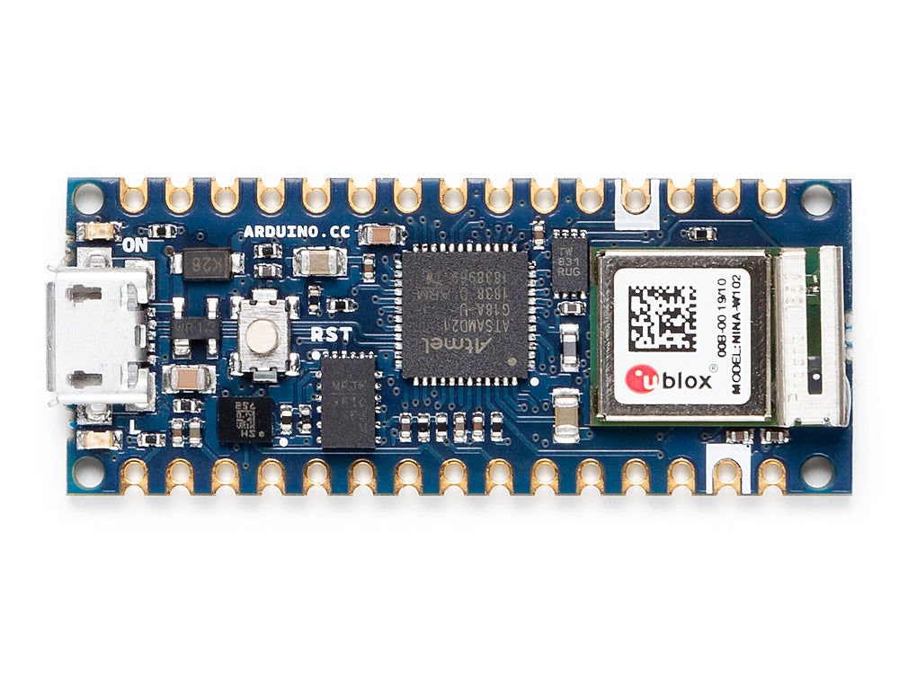

Thanks Runger!,
Seems to compile for the Arduino Nano Iot board. And, it has an Arm® Cortex®-M0 32-bit SAMD21. Would that work do you think? Or, is the STM32 Nucleo-32 the way to go? Is there a better option for that form factor? Thanks again.
Hey,
Yes the SAMD21 on the Nano33 IoT is supported, as are most of the Nucleo32 boards (F1,F4,G0,G4,L4).
Please check that these MCUs have enough pins for your needs… but for running one motor it should be enough.
