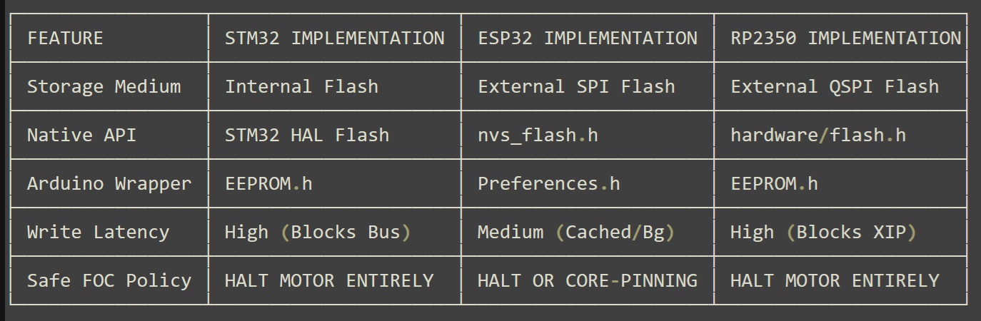

GPT stated, that all of our favourite MCUs have inbuild means to use flash memory to emulate EEprom.
Comparison chart:
It also came up with a SimpleFOC_EEPROM.h proposal, but I’m sure it’s not bulletproof
