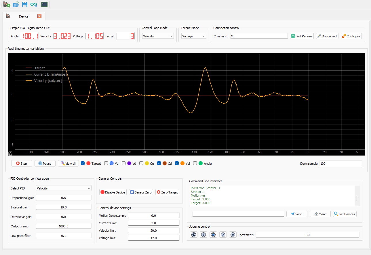

Hi! I have been trying getting closed loop to work with my custom DRV8841 + ESP32-s3 board for a nema17 stepper.
This is the velocity behaviour in closed loop.

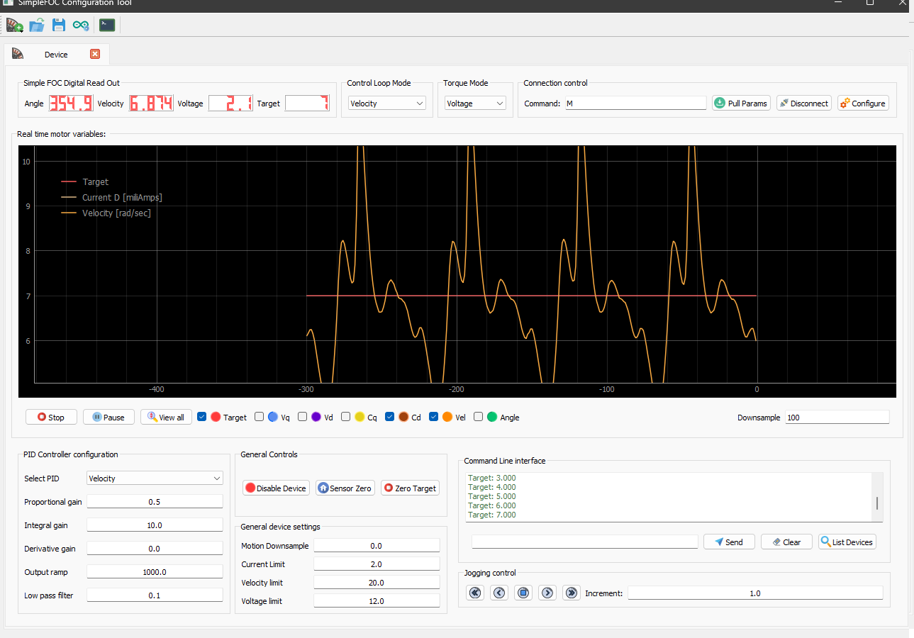

This is with a higher target velocity.

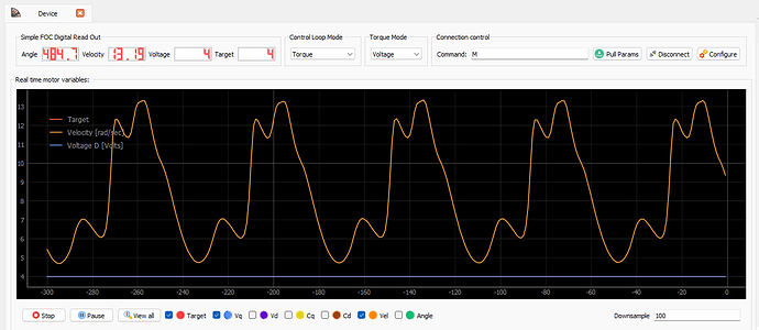

Behaviour in torque closed loop
Higher target torque

I have tried increasing the velocity LPF without much improvement.

Fine-tuning the zero_electric_angle seemed to help quite a bit
