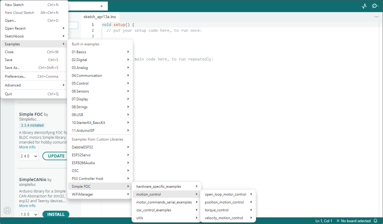

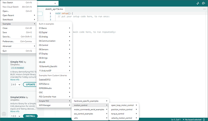

Hey, I’m working on a similar project with an STM32474 Nucleo Board and the BOOSTXL-DRV8323RS Dev Board and AS5048 Encoder. However I’m not sure where to find FOC controller code/libraries. I want to be able to set velocity, position, and torque of the motor.
Any help would be great thanks!
What IDE are you using? In Arduino it’s just listed as simplFOC in the library manager.
There are examples.
