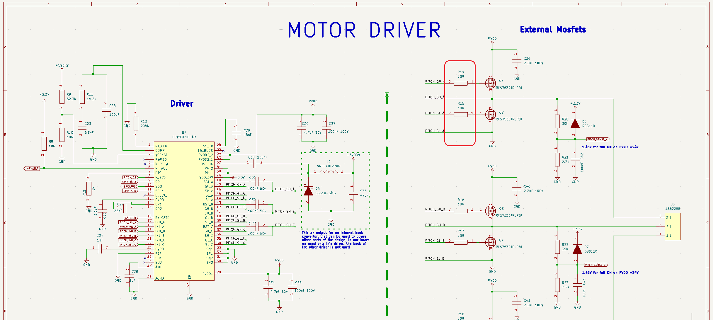

Hello,

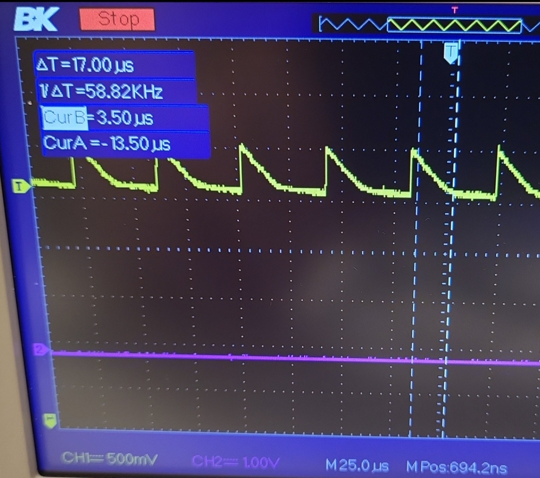

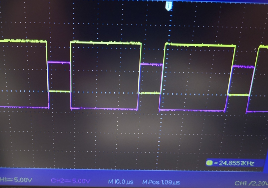

I’m trying to create a driver with the DRV8301 not sure what kind of resistor fits these mosfets. Have added the schematic picture (cant upload schematic files..) if anyone feels like weekend coziness check. I am a little unsure about the value of the gate-resistors like R14 and R15 for this mosfets (IRFS4229PbF) I get bad PWM values on mosfet using 10ohm resistor (in driver datasheet) but fine PWM before resistor..
