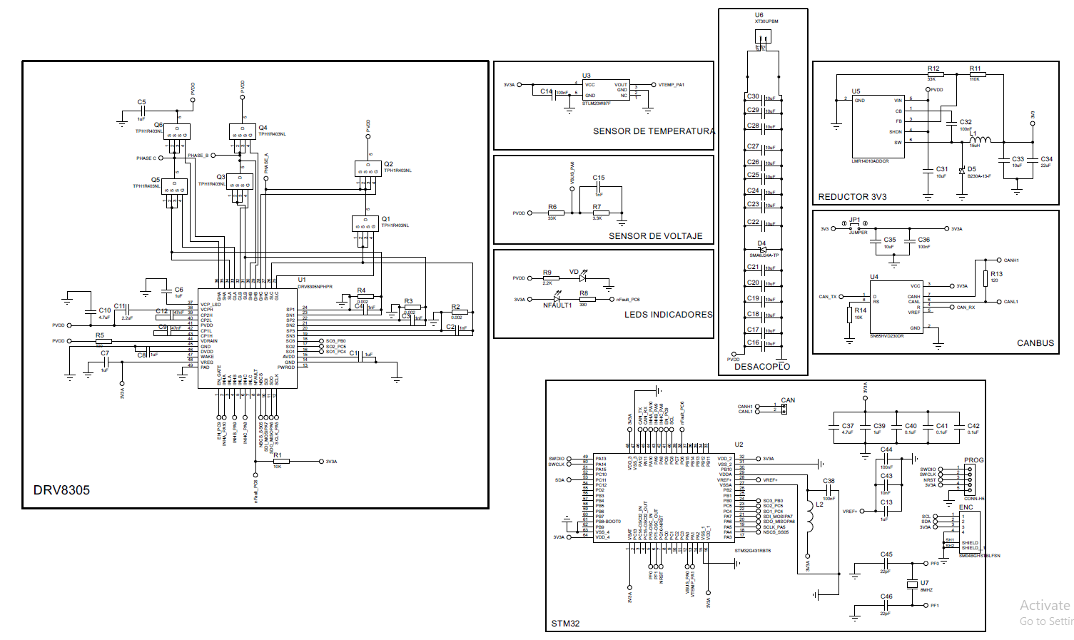

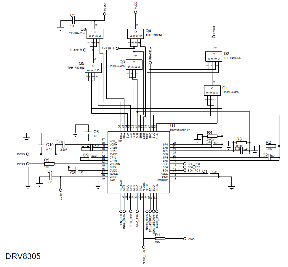

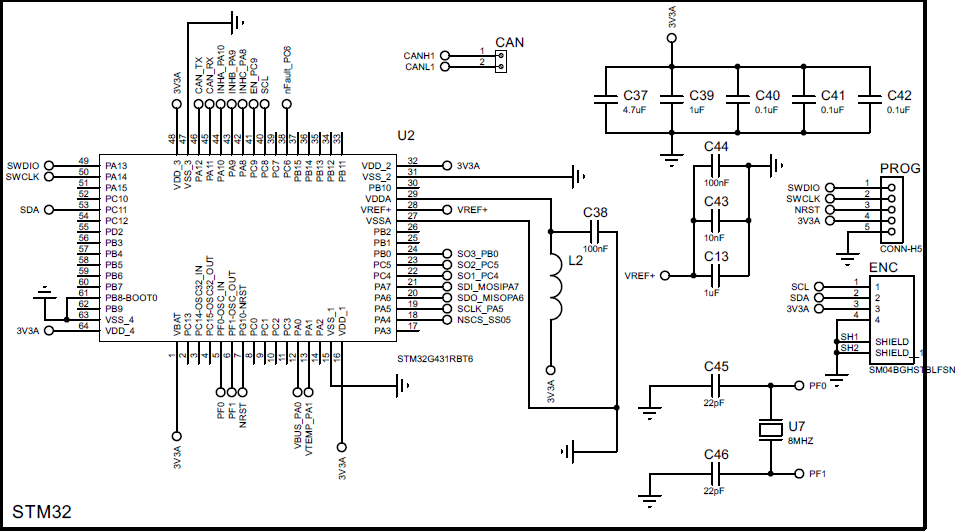

Hi guys, I designed a PCB with a STM32G431RBT6 and DRV8305.
When I upload the open loop example and change mi pins for the 3PWM, the motor does not spin, I measure the PVDD and the VCP of the DRV, I supply the PCB with 14V so in the PVDD I measure 14V and in the VCP 24V.
In the phases A, B and C I always have 14V, doesn’t matter if I put all in LOW.
Do you have any idea of what’s happening?

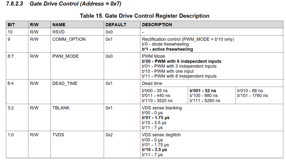

I figure out, I don’t have idea that the DRV8305 needs to configure the 0x07 register for 3pwm.
