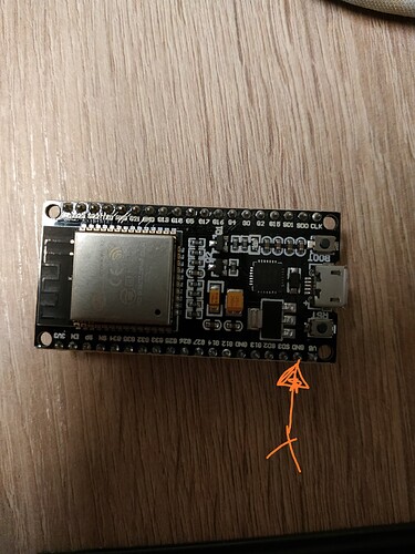

Thanks for your reply. I found the reason . This land is on the board, it is not. I don’t know what it’s for, but I’ve been looking for a very, very long time for a reason why the motor doesn’t turn, but makes strange noises. This pin is still located next to the 5V, so it is convenient to connect…
Ha, I’ve had exactly the same problem before…
The reason is that your board has a silkscreen error. This pin is not GND, but CMD, part of the flash memory interface. you can’t use it.
The original DevKitC boards pictured in the Espressif documentation label the bin correctly.
