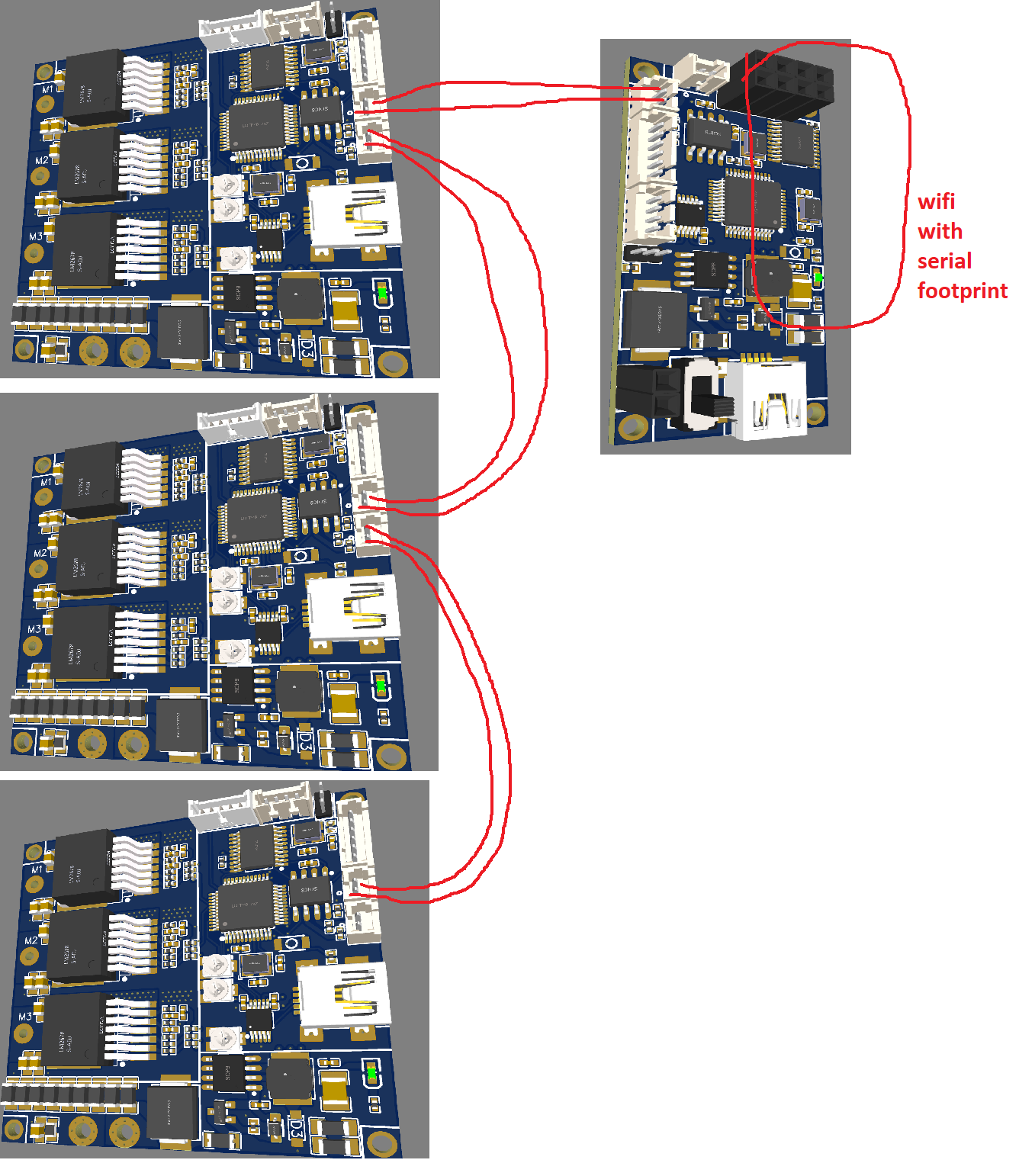

I am solving a very similar problem but with esp01 wifi, the answer is yes but you wont like it. Ill post what i did once i get to my office.
Edit: I am controlling multiple motors through a single esp-01 stock firmware (AT commands) wifi module which uses serial. I am streaming the data to a wifi module I designed where I have a read processing loop doing nothing else but the “brain” work of receiving, parsing and interpreting the wifi data stream via Serial. Then I send the motor commands using CANBus to the individual motor boards which they receive and use a hardware SPI chip with an interrupt to include the command inside the motor loop. The SPI chip handles the canbus and everything, and I use a simple SPI library with minimum overhead to get the commands and pass to the motor loop. Using interrupts guarantees no delay.
motor.loopFOC();
// here is the SPI / CANBus interrupt-based command
In your case this may be an overkill however it is a generic and reproducible solution guaranteed to work in a high-speed, long cable, noisy environment.
Downside is you have to make your own boards or at least manufacture the SPI/Canbus module and dedicate another board to handle the bluetooth. Asking the motor control board to both run the motor and process communications inside the motor loop may not be very practical.
