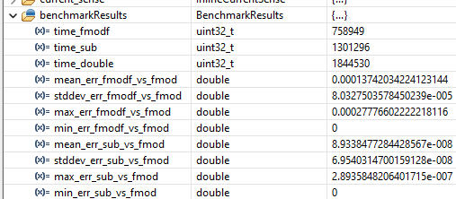

I’m wondering if this is dependent of the MCU architecture, which MCU type are you using?
You could maybe write a small test program that we could use to benchmark the execution time difference, that way we have a bit more info about how much better it is.
But yeah, we’ve established the fmod as a bottleneck in past as well and minimized its use as much as possible in the code.
This is not a bit change, but as @dekutree64 says, a very critical one so we should make sure to test it well. :slight_smile:
Maybe this is the moment in life of SimpleFOC to add some unit testing.
Wrote a bit of cpp code to test the accuracy of these. Can be copied over to Online C++ Compiler - online editor and executed there.
First tests show it is a bit less accurate than the fmod itself - max difference of 0.006 (0.1%) instead of 0.002 compared to a ‘clean’ calculation using doubles. It is also faster here, but these numbers don’t really hold when compared to running it on an MCU.
I couldn’t get the ones from dekutree64 to work, will have another go at that later.

@dekutree64 You were correct - on an arduino the int cast is way slower than the fmod. Arduino also doesn’t seem to have a double precision option.
This is what I’m getting:
Starting Angle Normalization Benchmark
=== PERFORMANCE BENCHMARK RESULTS ===
Timing results for angle normalization methods:
fmod method: 256 microseconds
Subtraction method: 496 microseconds
Double precision method: 252 microseconds
=== ACCURACY BENCHMARK RESULTS ===
Differences compared to double precision method (baseline):
fmod method error statistics:
Mean Error: 0.000000
Standard Deviation: 0.000000
Maximum Error: 0.000000
Minimum Error: 0.000000
Subtraction method error statistics:
Mean Error: 0.000088
Standard Deviation: 0.000079
Maximum Error: 0.000231
Minimum Error: 0.000003
With this piece of code, running on an Arduino Nano.

I have results on the STM32G4!
Clock cycles for 2000 original function calls: 1.8M
Clock cycles for 2000 ‘substraction’ calls: 1.3M
But - during testing I figured out fmod() on the STM32G4 always uses doubles. The right function to call for floats is fmodf(). Which only takes 759k cycles for the same 2000 operations. :slight_smile:
That said, the substraction method does seem to be more accurate, or at least more similar to the double variant. Not super readable but the information is there:
I’ll be moving to the fmodf() on my board! Saves me 250+ extra clock cycles over the substraction method, and 500+ over the original fmod().

Arghh in practice my motor control loop runs at the same speed with both fmod and fmodf, and I can’t figure out why. There the “subtraction method” is still fastest…
