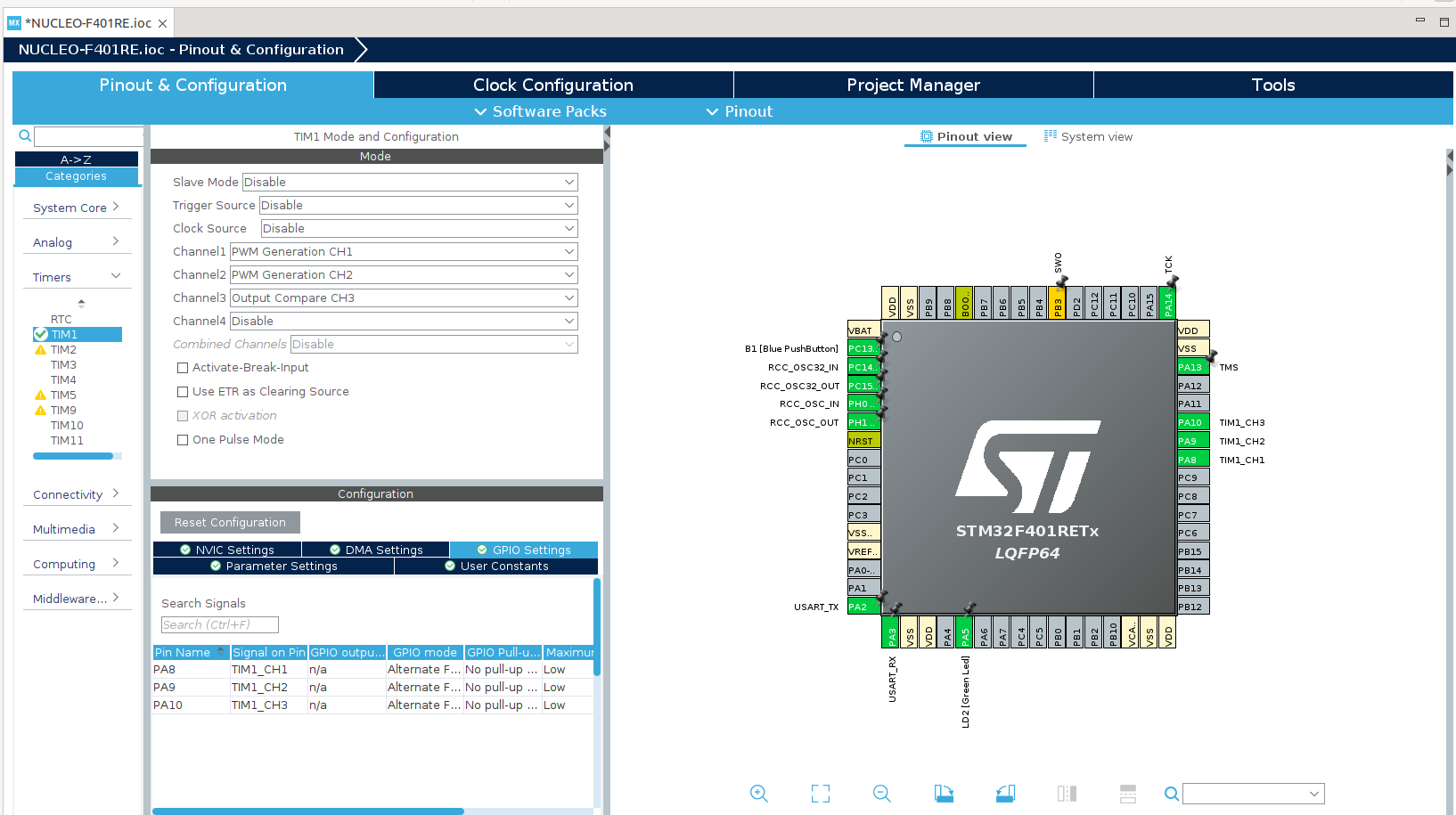

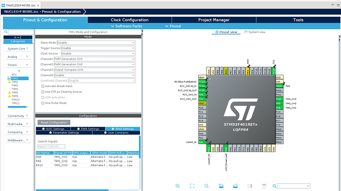

I got myself a nucleo-64 and started over trying to get the open_loop position work and got myself struggling again.
The open_loop positioning seems to work fine with the adruino uno but when i try it on the nucleo-64 it seems does not work at all. both boards are using the exact same code and pins. The only difference i see is that the nucleo outputs 3.3 volts to the pins and the uno 5v. I don’t think this should be a problem because according to the datasheet the drv8302 should 3.3v and 5v interface support. did anyone else struggle with this as well?
Is it a NUCLEO-F401RE, you have to be a bit more selective with pin choice with stm32. What pins did you go for? PA8, PA9 and PA10 seem sensible for 3xPWM.
Thank you! The open loops works now for me. im indeed using the NUCLEO-F401RE.
