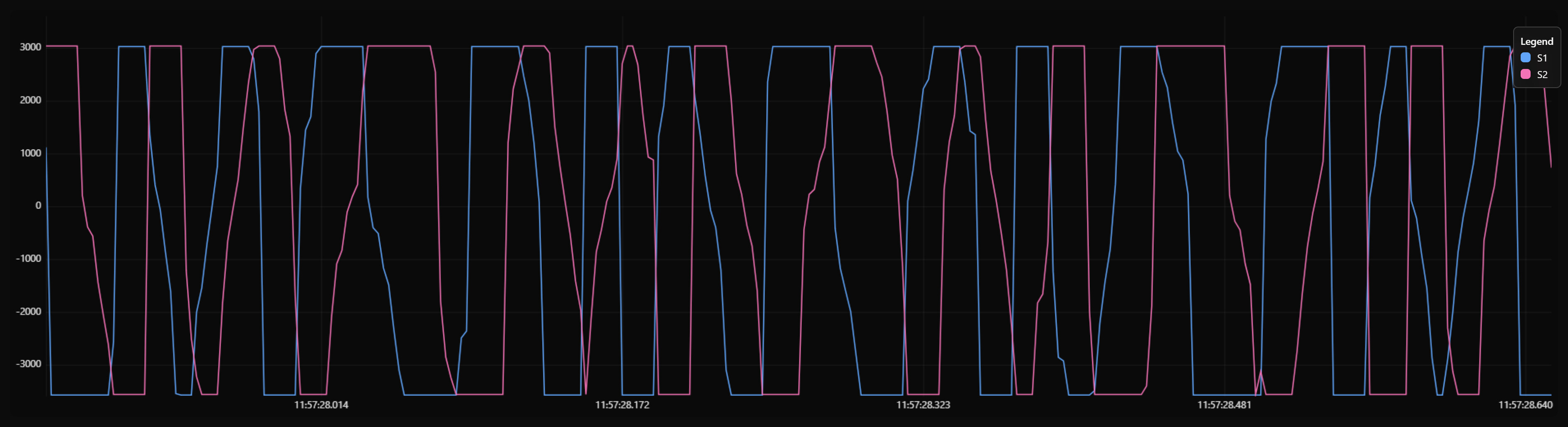

ADC is clipping, current measurments are wrong
My Iq and Id are always extremly hight values.

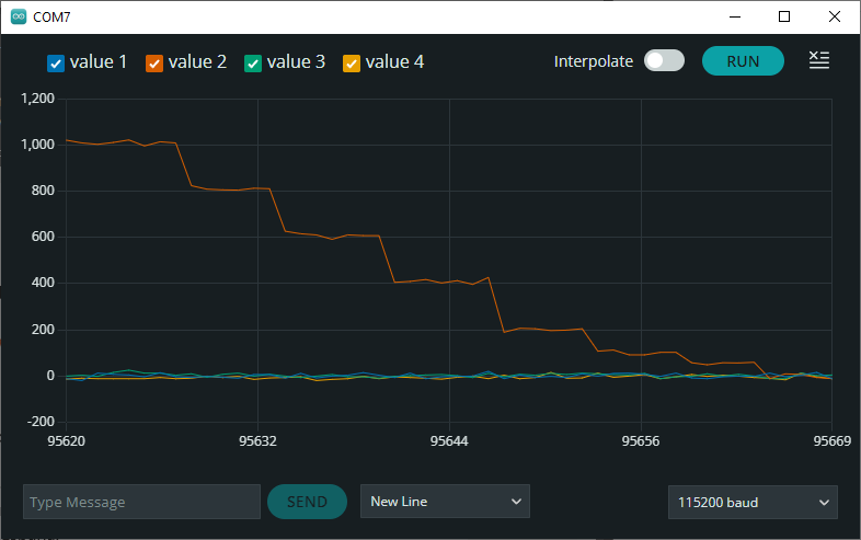

The power supply is showing at most 750mA while the plot is showing clipping past 3A (you can easily stop the motor by hand, it’s not 3A):
I’ve tried adding analogSetAttenuation(ADC_11db); in the code but i see no difference.
I’m pretty sure my current sense is setup properly, verified with a constant current source from 1A down to 0A:
How does SimpleFOC decide on the gains? Why is it being so aggressive?

The saturation actually looks ok its around ±3A which is more or less ±1.5V (for the 3.3V logic).
Are you running your motor in the open loop?
What is the phase resistance of your motor?
It is eniterely possible that you have 3A on the motor and that you can stop it by hand, it really depens on your motor.
Also the power supply current is not equal to the phase current. The power is conserved (voltage*current) rather than the current magnitude (roughly).
So if you have a 20V power supply and you read 750mA. When you set 5V volatge to your motor you should read 20*0.7/5 = 3A. This is just an example though.
So it seems to me that this is likely a combination of the physical saturation of your current sensing and a high motor current.

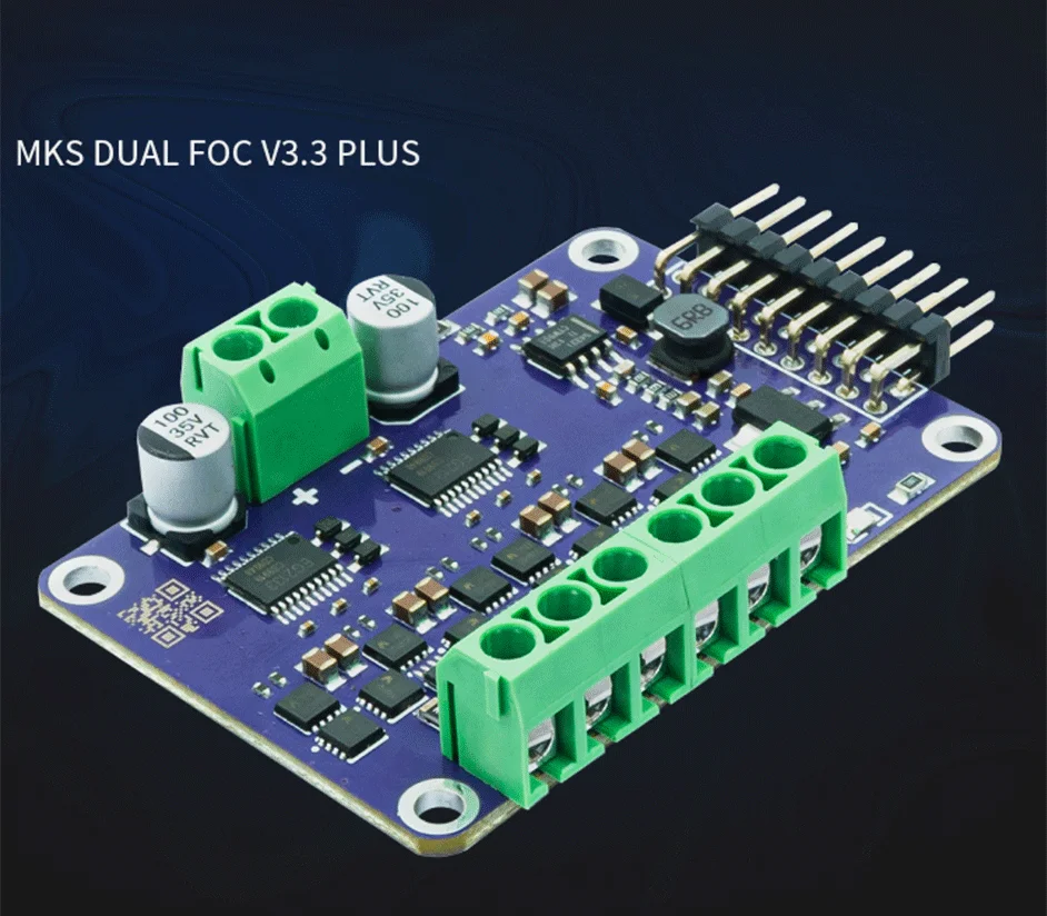

MKS FOC DUAL PLUS v3.3 with INA240A2

We have already had a couple of users that tried to use these boards and have had issues with the current sensing circuit design. Even though the board is capable of outputting 10+ Amps it is not capable of measuring more than 4A.
You would need to change the shunt resistors to a smaller value to allow measuring a larger range.
It is really a pity that they’ve done it this way.
So it you use voltage or estimated current control you do not use the current sensing circuit and you can use the full potential of the board. If you use the foc current control mode you will be limited to 4 amps.
And for your motor, 4 amps is not much.

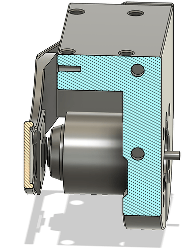

AS5600 will always vibrate a little bit. 14-bit is much better, and the 21-bit MT6835 is awesome.

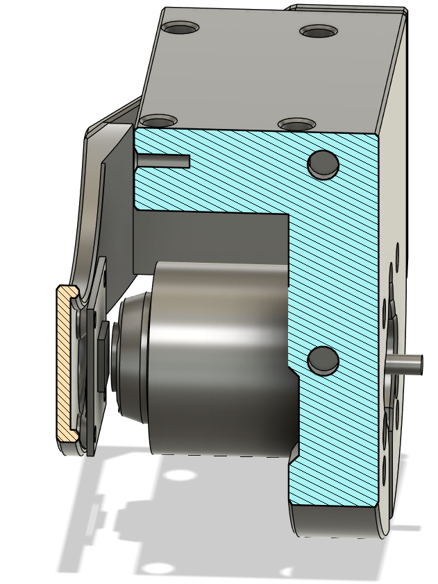

Need to assemble the parts, but I’ve improved the magnet centering on the motor and decreased the distance between the encoder and motor. Added some extra room for ventilation too as at 4A they do get quite toasty and I’m worried about the longer term stability with PLA xD
… finding M2 screws for the encoder is gonna be a bit of a pain tho.
