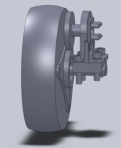

I have just started to design a timing belt rig to rotate the magnet for an external encoder.
My idea is to glue a timing belt on the cylinder and use it to make the teeth of the gear.
I will have to be acurate when gluing the belt… I will see if it works ! It should as almost no effort is needed on these gears…Only rotate the magnet !
And as the two gears will have exactly the same number of teeth it must work with simpleFoc !

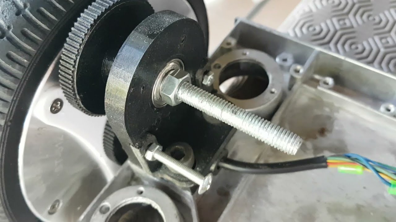

I have progressed on the encoder mount.
Seems to be feasible !
I will keep the aluminium plate of the hoverboard and fit the encoder mount on 2 of the 4 screws which fix the motor axis.
And after an hour of printing the result is there !
I have to cut the screw and put the magnet in place on it ; then the encoder will no longer be a problem !
