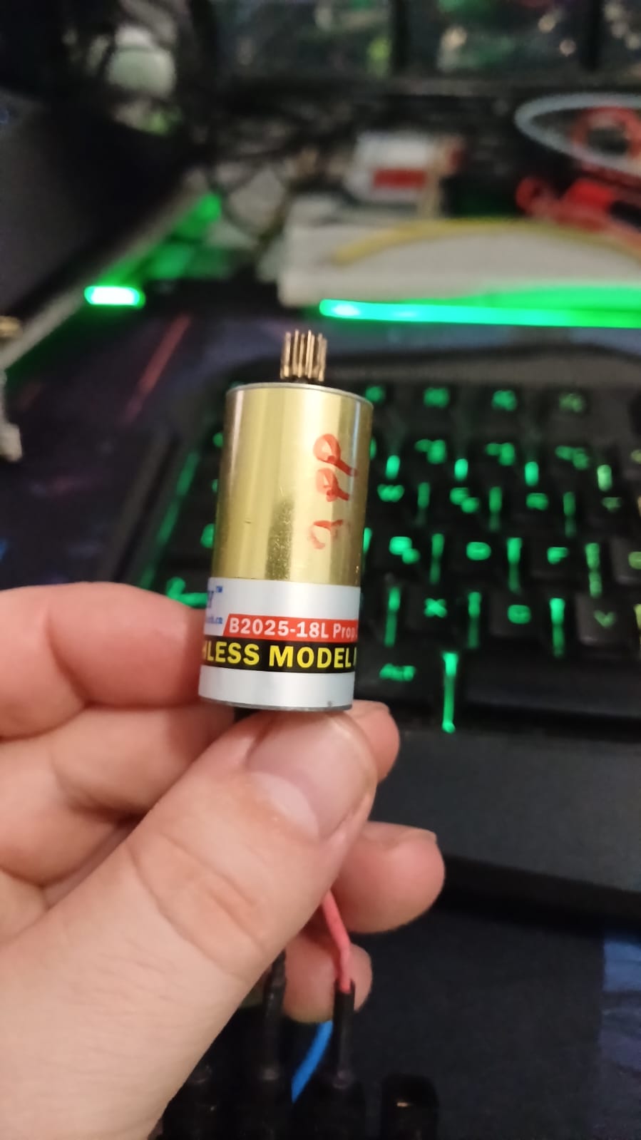

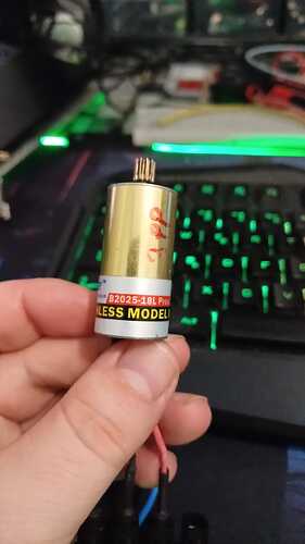

Here is the motor.

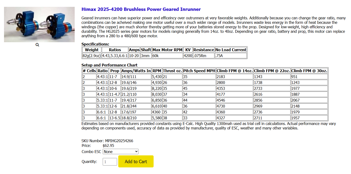

I bought this engine ten years ago. I could not find manufucturer. But I found similar motor. I found the pole pair number as 3 by returning 2 radians from the software.

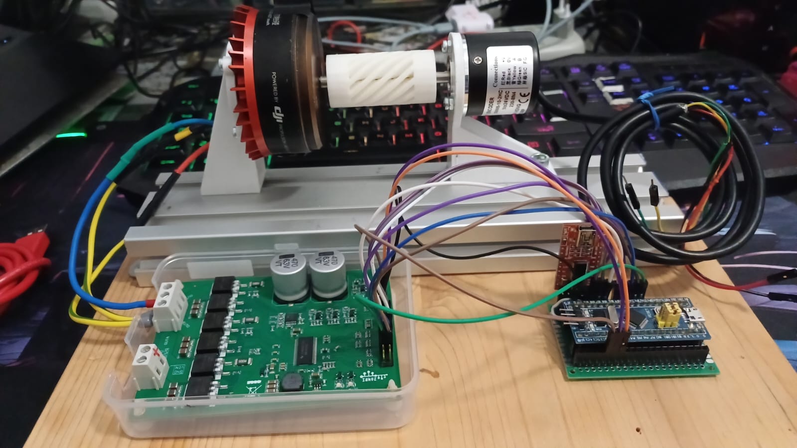

This is the new setup. I will continue with this setup. I will share my findings here.
