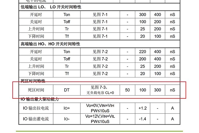

Is it a 6PWM driver, like the MKS dual FOC? Then it’s worth increasing the driver.dead_zone because you might see shoot-through.
I had trouble with high inductance motors and checked the datasheet of the EG2133 drivers.
Their inbuild dead-time was as short as nano-seconds IIRC.

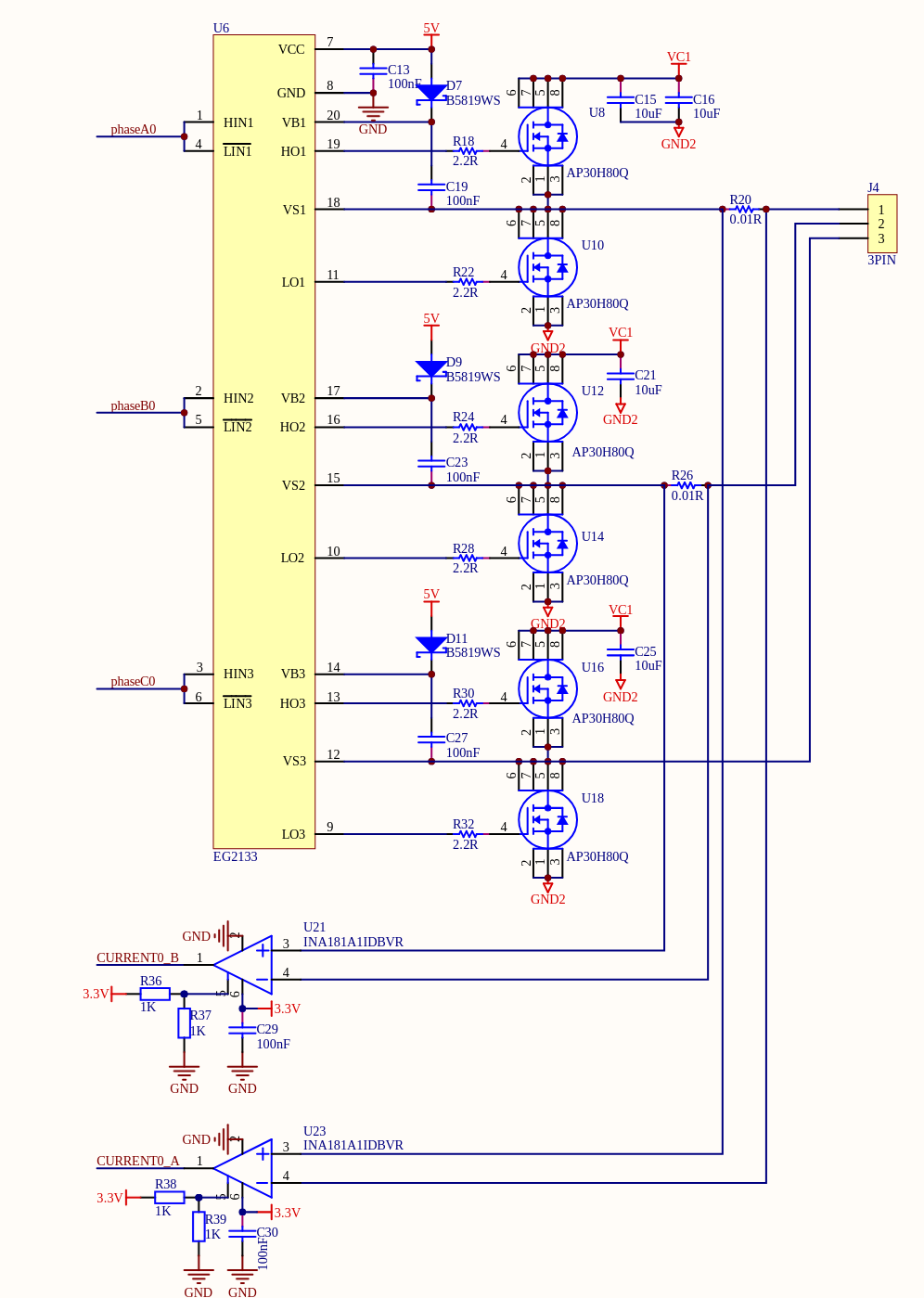

Hey @o_lampe !
Thank you for your response!
Looking at the schematic of the FOC controller, I believe it uses a 3PWM configuration. Here is the circuit for one of the channels:
That’s even worse, because now you have to rely on the internal dead-time which is 100ns typical.
Seems the whole thing is meant for slow gimbal motors.
