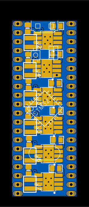

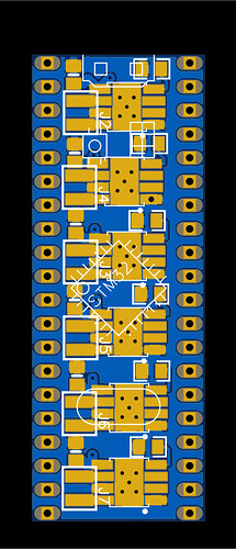

I am also going to order PCB with 2 BLDC controller hat for STM32F01 blue pill using 6 DVR8871 chips.
I have to rout inputs pins from blue pill to 6 DRV8871 chips but could not identify pins so can you please give me hint about what pins should I use for SimpleFOC?
Thank you.

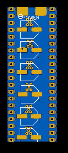

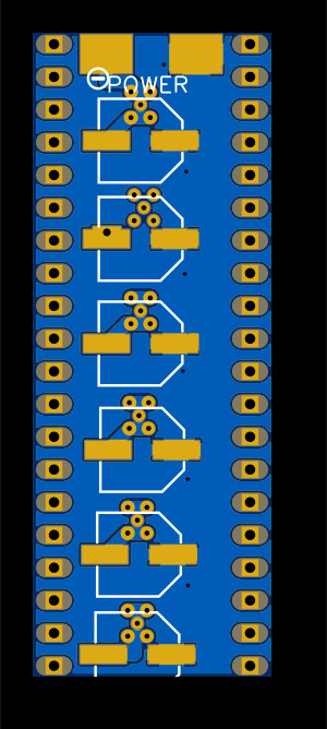

You were right in your earlier response that NDM3000 is not suitable so I will go with 6 individual pair of N and P type mosfets with BDR6300.It will take little more space on PCB but it will be more flexible for selection of mosfets and to replace mosfets if something goes wrong with one of them. The datasheet of BDR6300 is not very clear about exact type of mosfets suitable for that chip.
I will be driving 2 BLDC with 12 mosfets (6 N-type and 6 p-type) as @Antun_Skuric demonstrated it with L298N in this thread.

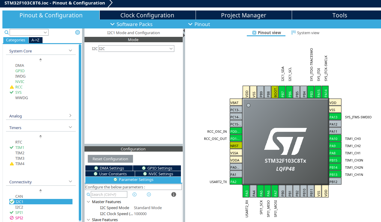

Regarding pins on bluepill (STM32F103C8T6) - you are looking to choose pins on one of the advance timers (typically TIM1 and sometimes also TIM8).
stm32cubeide has a tool to help chose the right pins, this is an example of setting up blue pill for various peripherals:
