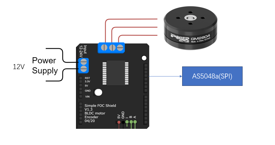

Here is my code and my system:
// encoder instance
MagneticSensorSPI encoder = MagneticSensorSPI(AS5048_SPI, 10);
encoder.init();
motor.linkSensor(&encoder);
// driver init
if(!driver.init()){
return;
// link driver
// aligning voltage
motor.voltage_sensor_align = 5;
if(!motor.init()){
Serial.println("Motor init failed!");
return;
if(!motor.initFOC()){
Serial.println("FOC init failed!");
return;
// set the initial motor target
motor.target = 2; // Volts
// add target command M
command.add('M', doMotor, "Motor");
Serial.println(F("Set the target using serial terminal and command M:"));

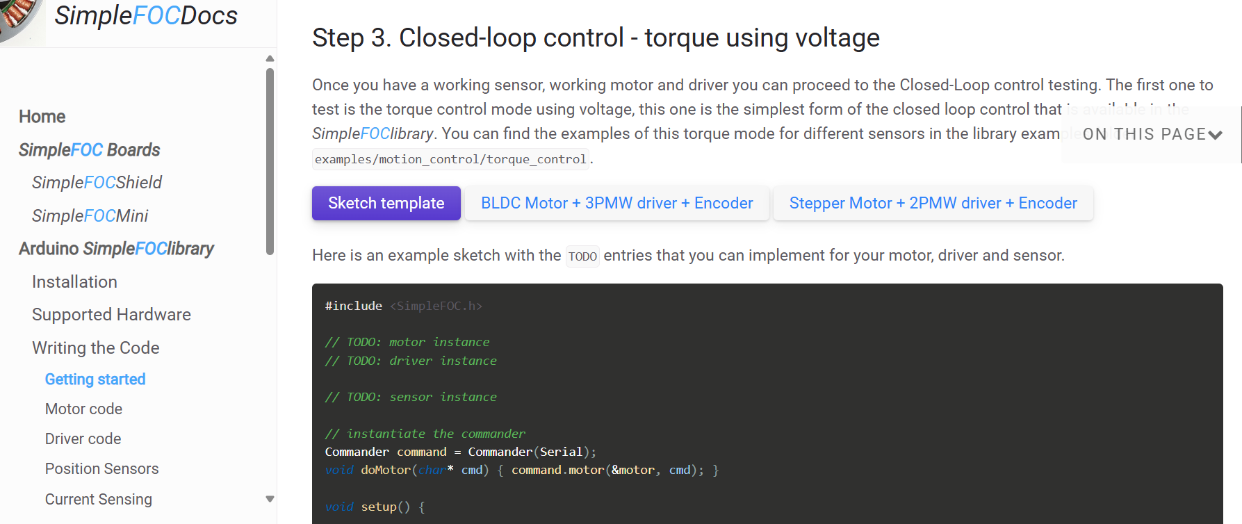

I ran the “getting start” section right but got wrong in the step3:
when I monitored the arduino, it seemed normal because it initialized right:

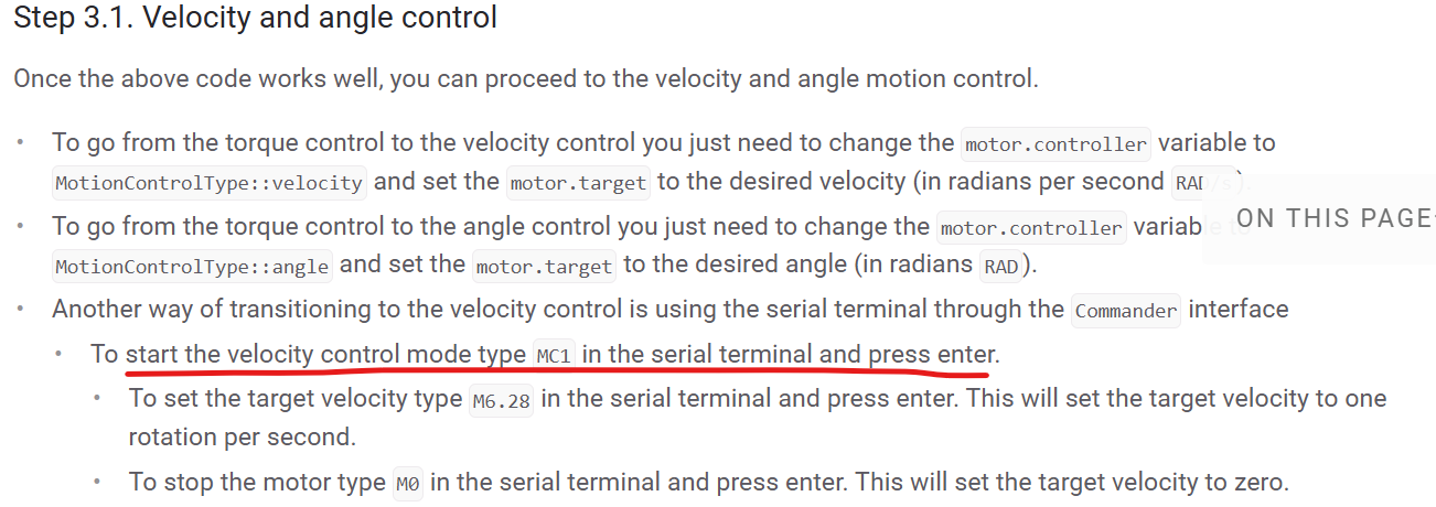

but when I input “MC1”(which means changing the system to “vel” model as the guide says):
The motor vibrates so violently that it “scurries” around the table. Why?
