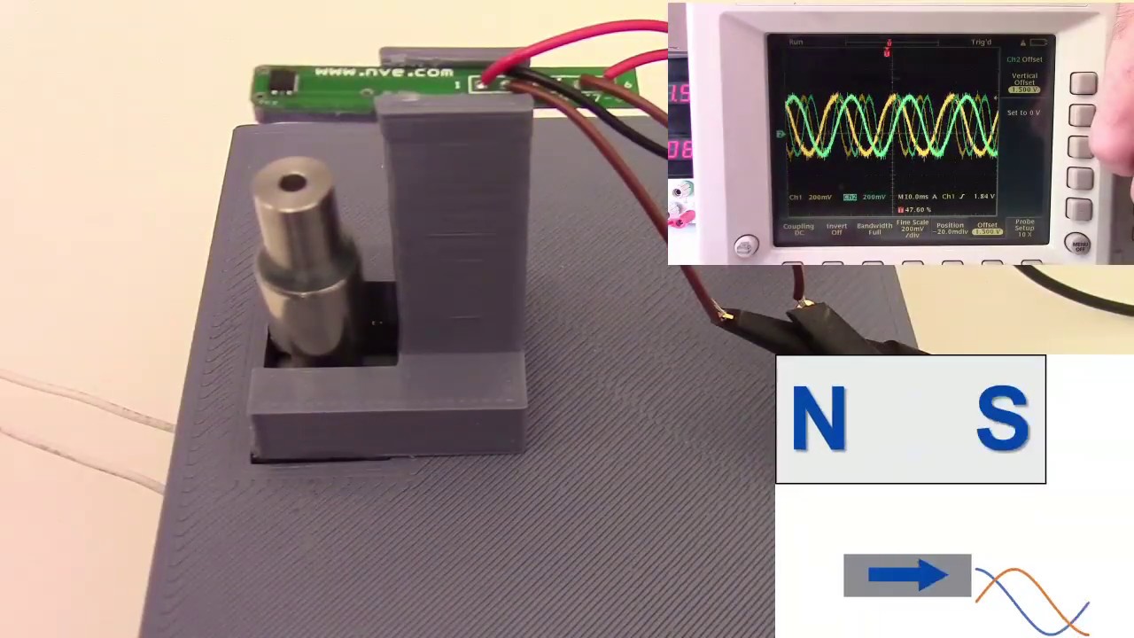

NVE has several videos using their sensors in off-axis configurations, e.g.:
Hey, thanks for sharing that video, that is interesting!
If you try It out, please let us know how it goes.
