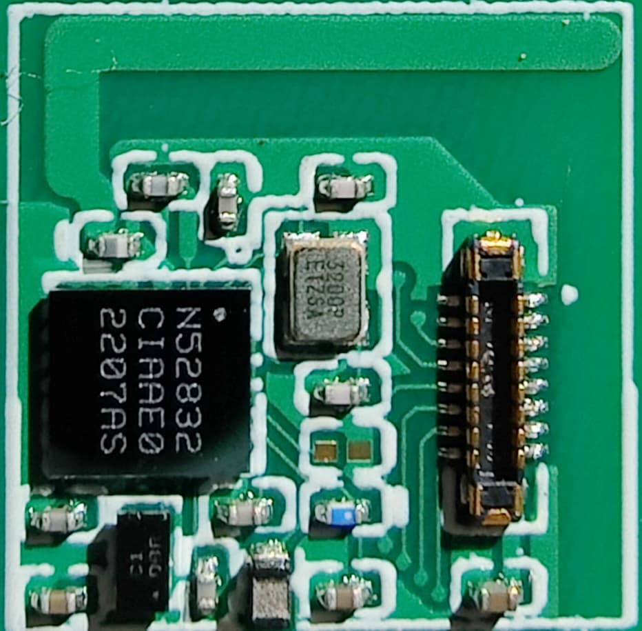

Updating the progress with something that could potentially be used as a SimpleFOC MCU, you can see the full progress up the original post.
The tiniest nRF52 break-out development board and the tiniest board I’ve ever created.
External DC/DC converter inductance.
External TCXO 5ppm accuracy (about 2 minutes/year deviation).
Built-in antenna.
Break-out connector.
80 micron traces.
BGA MCU (the one JLC dropped and they had to re-fab my PCB…)
The real question, will it work? Stay tuned!

wow! how much extra do you pay for that?
$200 for 2 including shipping. I believe it’s about $50 extra. They also failed to manufacture on the first try, so we went for round 2, lol.
