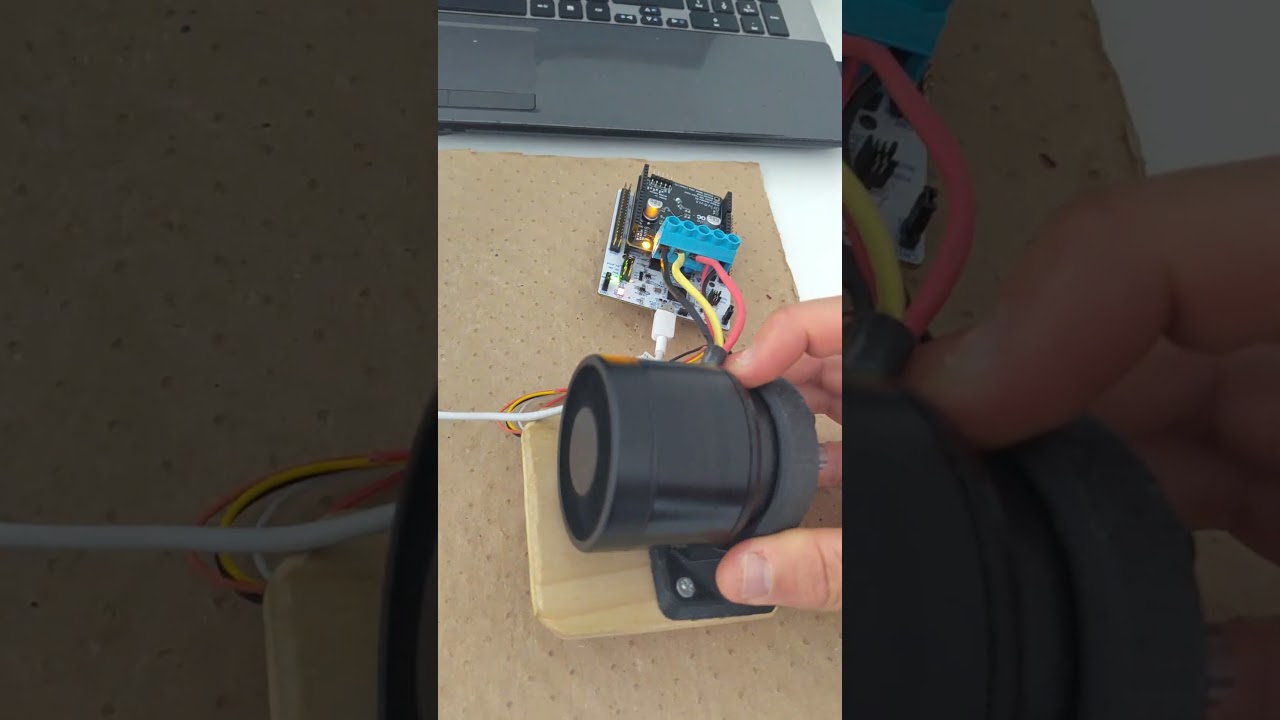

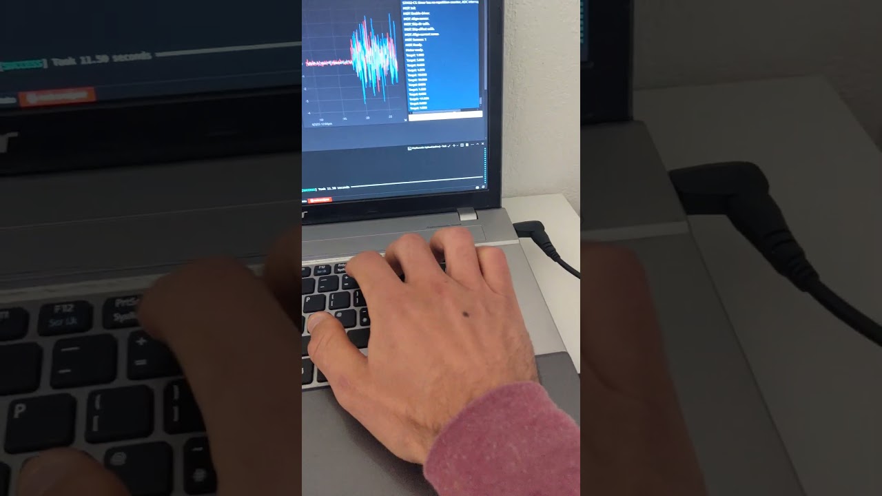

Here are some cool videos (that are a bit scary too).
The motors are torque controlled and I’m setting the torque target value in amps. In both cases I’m using a nucleo g747re and the SimpleFOC Drive shield. The current sensing is inline, but I’m using low-side as it is much faster.
The motor parameters are measured using the motor.characteriseMotor(1.0); method.

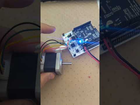

And a nema17 motor:
StepperMotor motor = StepperMotor(50, 3.9f, 35.0f, 0.018f);
