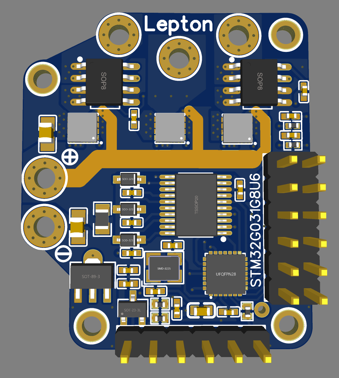

I designed the Lepton exactly as that, even the name was inspired by the Widow’s Mite story if anyone is interested. Couldn’t get any cheaper and easier than that. Also I did and opened a 4-layer version if anyone is interested. Then, if you replace with G071 as @dekutree64 suggested, I genuinely do not see any other driver that could compete with that board at this combination of price point, simplicity and functionality. I believe the only cheaper and smaller with similar functionality would be the HotDog or the NanoDog, but the mosfet drivers for that one are end-of-life.
Great discussions here.

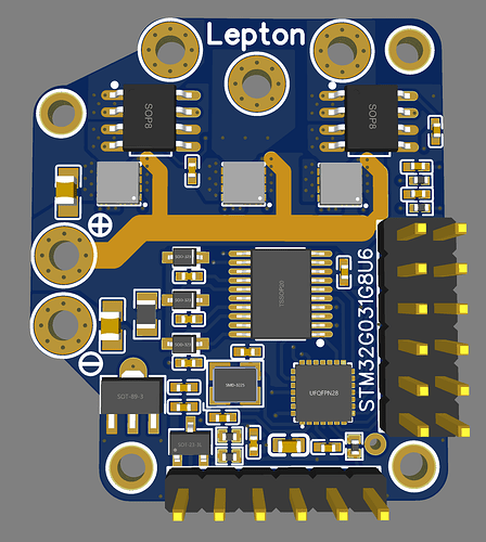

PS this is the first version of the Lepton, with 2.54mm headers, oscillator, no buck converter (two LDOs in a ladder) and two-phase current sensing. @Anthony_Douglas , as you could see, I have tried everything you already suggested, and this turned out to be a dud. That’s a failed design. I’m sure if I work on it, I can make it a success, but I’m not convinced at that point it’s worth the effort.
What was wrong with it?

The driver and the LDOs were a problem. I needed a different driver and proper buck converter – the current Lepton iteration has those. You can add current sense if you want, I used CC6903SO-30A JLC part number C469388, which costs 0.80 per chip, so adding current sense is $1.60 per board. If you add G071 (another $1.50) which is double the memory you will may be solve all your problems.

Used to be EG2133 which I replaced with FD6288Q.

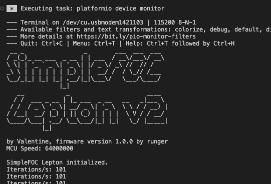

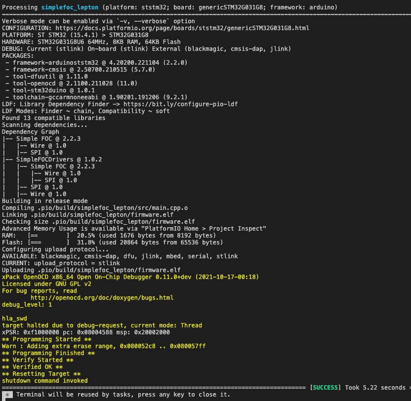

But anyway, as you’ve probably guessed from the above both programming via SWD and Serial IO are working nicely for me in PlatformIO.
Serial output:
This code, if you wanted to try it, is now checked into GitHub. I must stress that it’s work in progress still: GitHub - simplefoc/simplefoc_lepton_platformio: Firmware for the SimpleFOC Lepton Board by Valentine

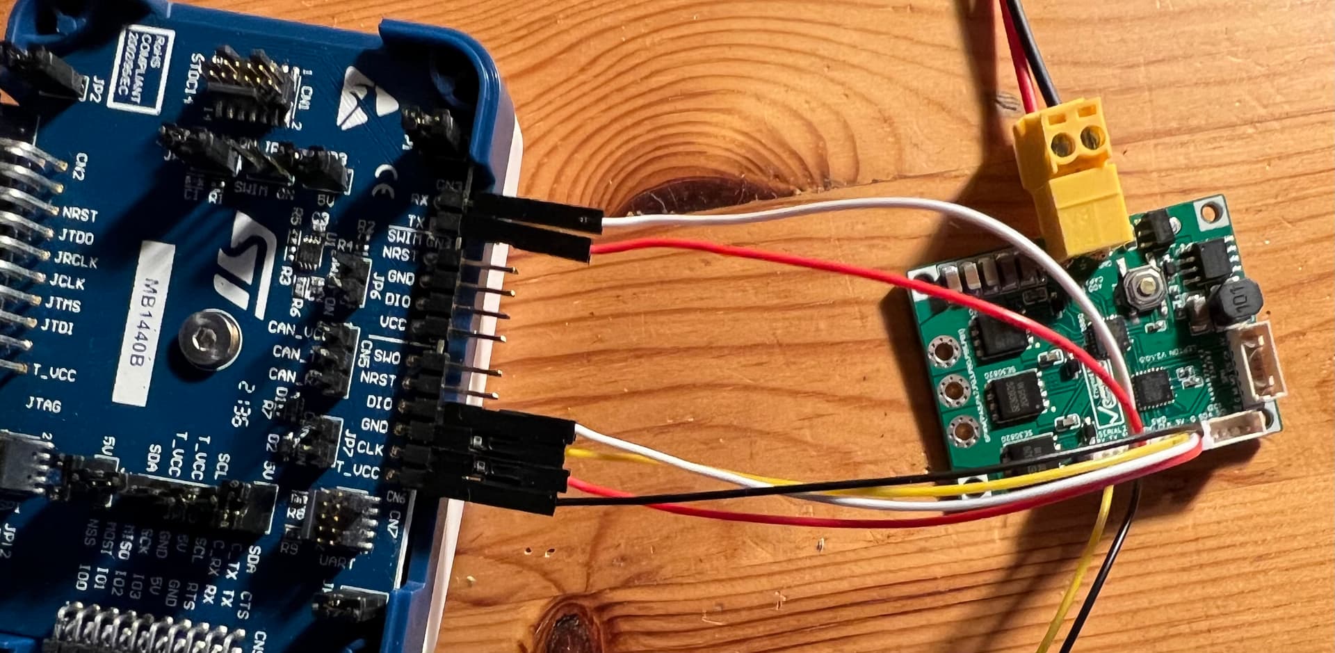

A quick pic… the lepton, powered via lab PSU at 15V and attached to the ST-Link for SWD and Serial
nioce. I’m open to learning to use platformIO. The silkscreen on that blue board appears to be slightly misaligned, it looks like a vcc is connected to a black wire. I do see a thing that might say gnd nearby…
No it says cn6, it looks like you have a black wire going from ground on the lepton to vcc on the board? I guess not if it works.

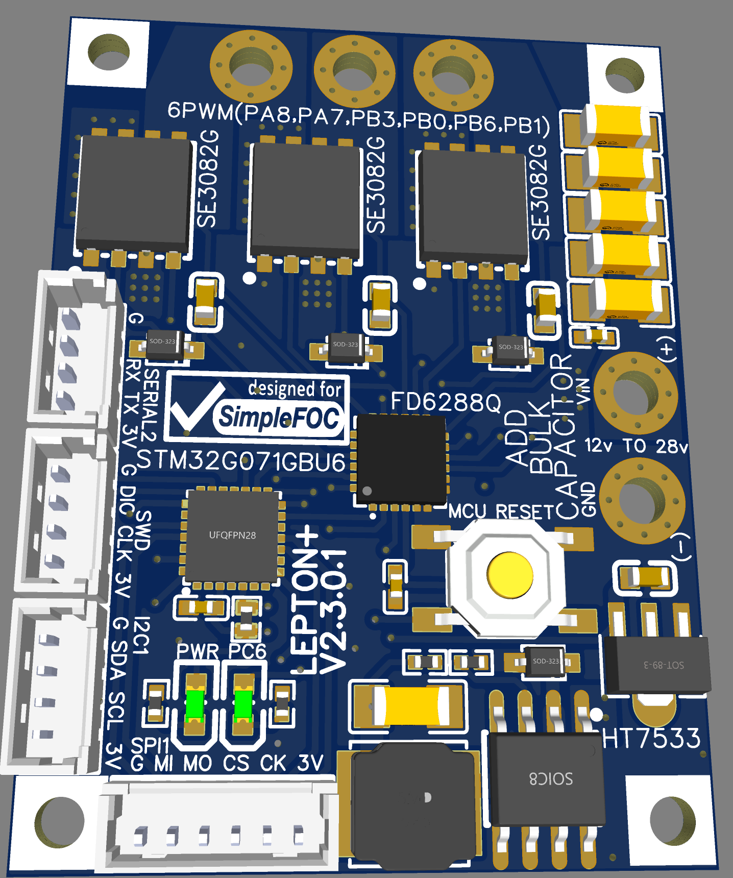

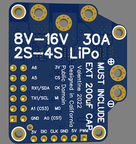

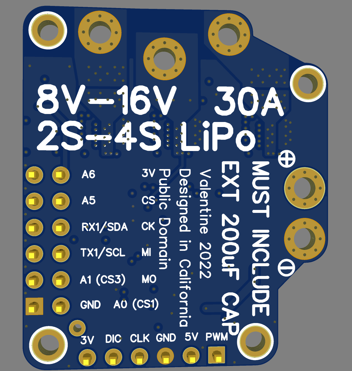

After your suggestions, I created a Lepton+ 4-layer variant with G071 and two LEDs - power and PC6. This would leave four analog pins free, three for current sensing and one for temperature sensor if anyone is willing to extend the design to a Pro version.
https://oshwlab.com/cost.co/20220903_bldc_se3082g_copy_copy
