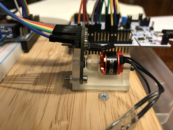

Thanks for the suggestions. I’m 95% sure that this is the magnet I’m using, which is diametric. It’s held dead-center over the sensor, within the sensor’s optimal range (per the sensor datasheet) by a 3D-printed motor mount and magnet mount:
I sometimes get 6ish rad per rev by spinning the motor with my finger. Sometimes I don’t though, and it jumps random directions up and down. I’m starting to wonder if I have a bad sensor, unfortunately. I’ll disassemble the mount and try the magnet sideways first before I pull the trigger on buying another sensor.
