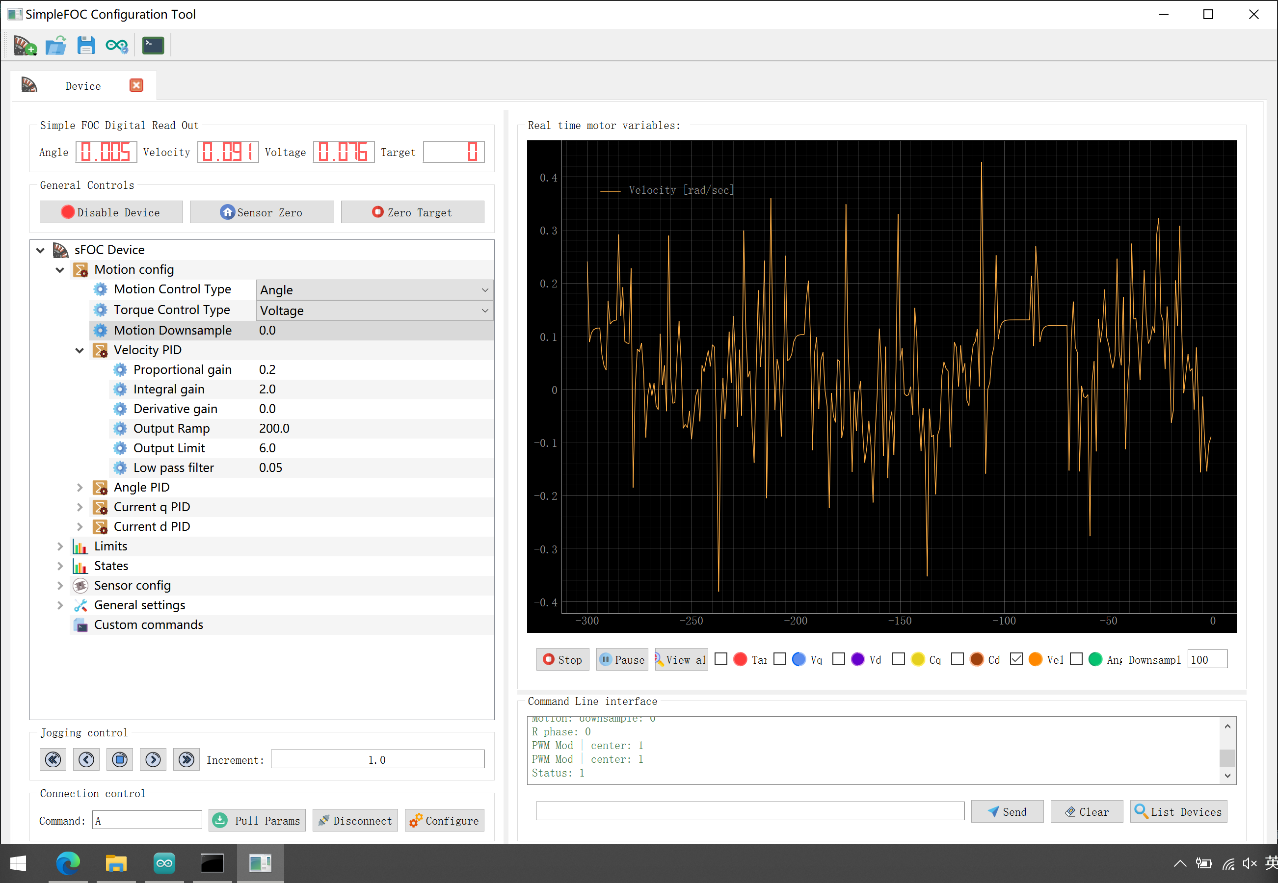

The following picture shows the v2.4.0 velocity noise level
This thus in position mode ,the motor can not stop stable, it continue moves a little bit left and right.
I try AS5600 and AS5047 sensor and also try STM32 and ESP32 MCU, same result. so this is not the hardware issuse. and I also try to adjust the PID and LPF, still not stable as v2.3.5

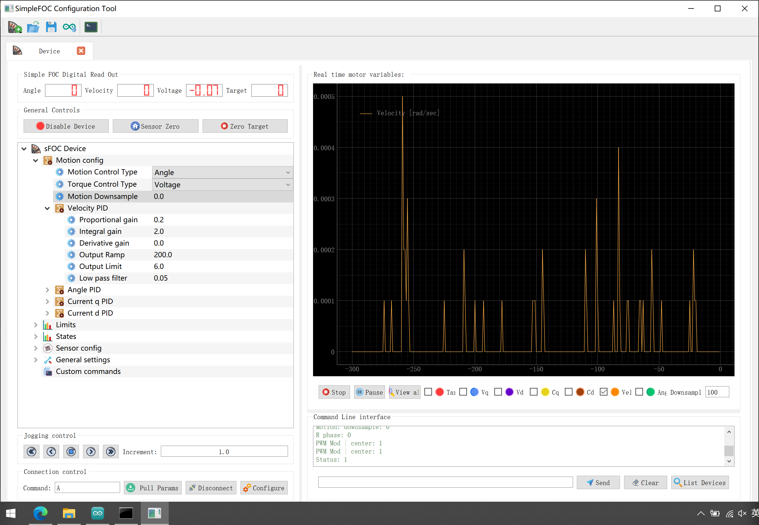

The following Fig shows the v2.3.5 velocity noise ,very low level.

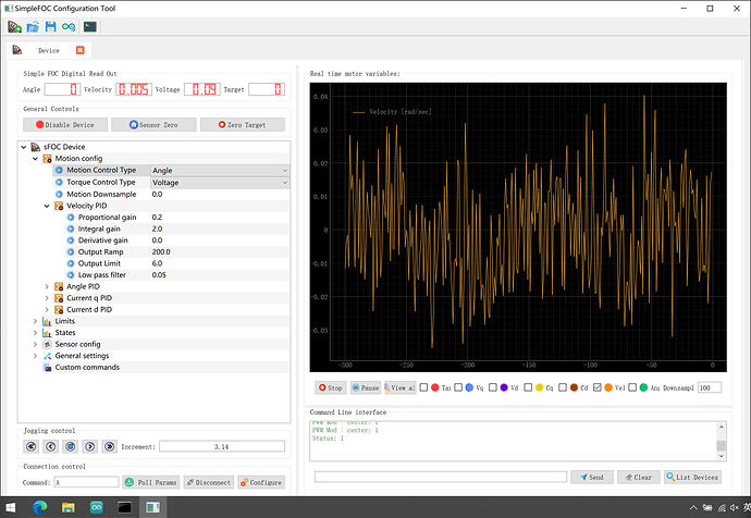

I tryed this parameter sensor.min_elapsed_time=0.001;//1ms
The noise level see fig below. seems better but still can not reach the V2.3.5 level.
