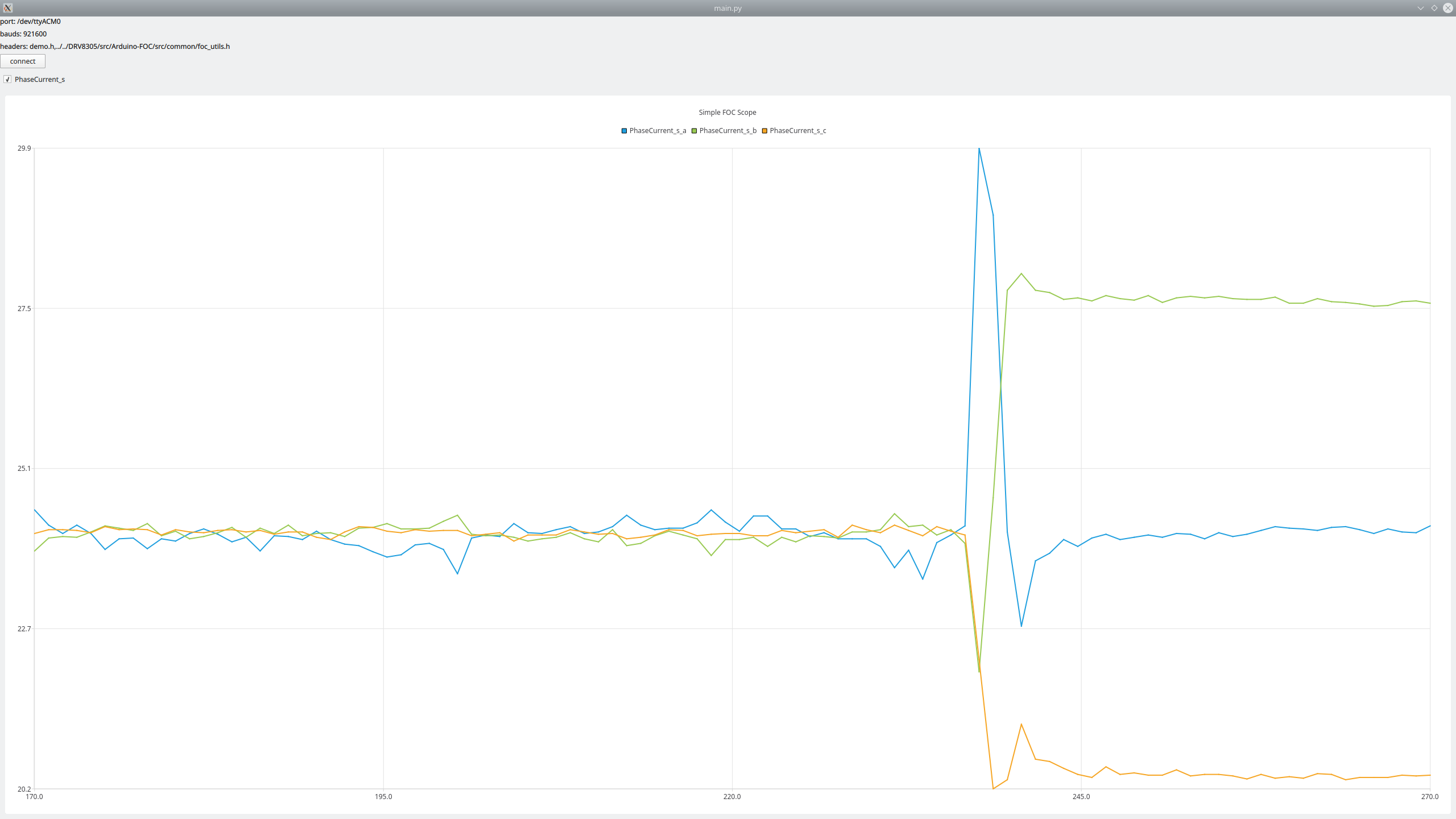

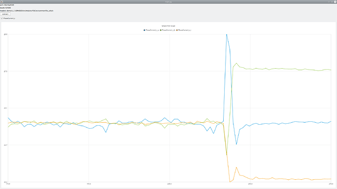

Before I went threre I managed to find out why I have always reading 1.71V
First, I forgot to load the factory calibration. with that I’m back at 1.69
@runger Please make sure you use the version I just pushed if you happend to find the time to check.
Second, it was as I suspected, I was reading during the pwm dead time. using TCC_WAVEB_WAVEGENB_DSTOP instead of TCC_WAVEB_WAVEGENB_DSBOTTOM
solved it!

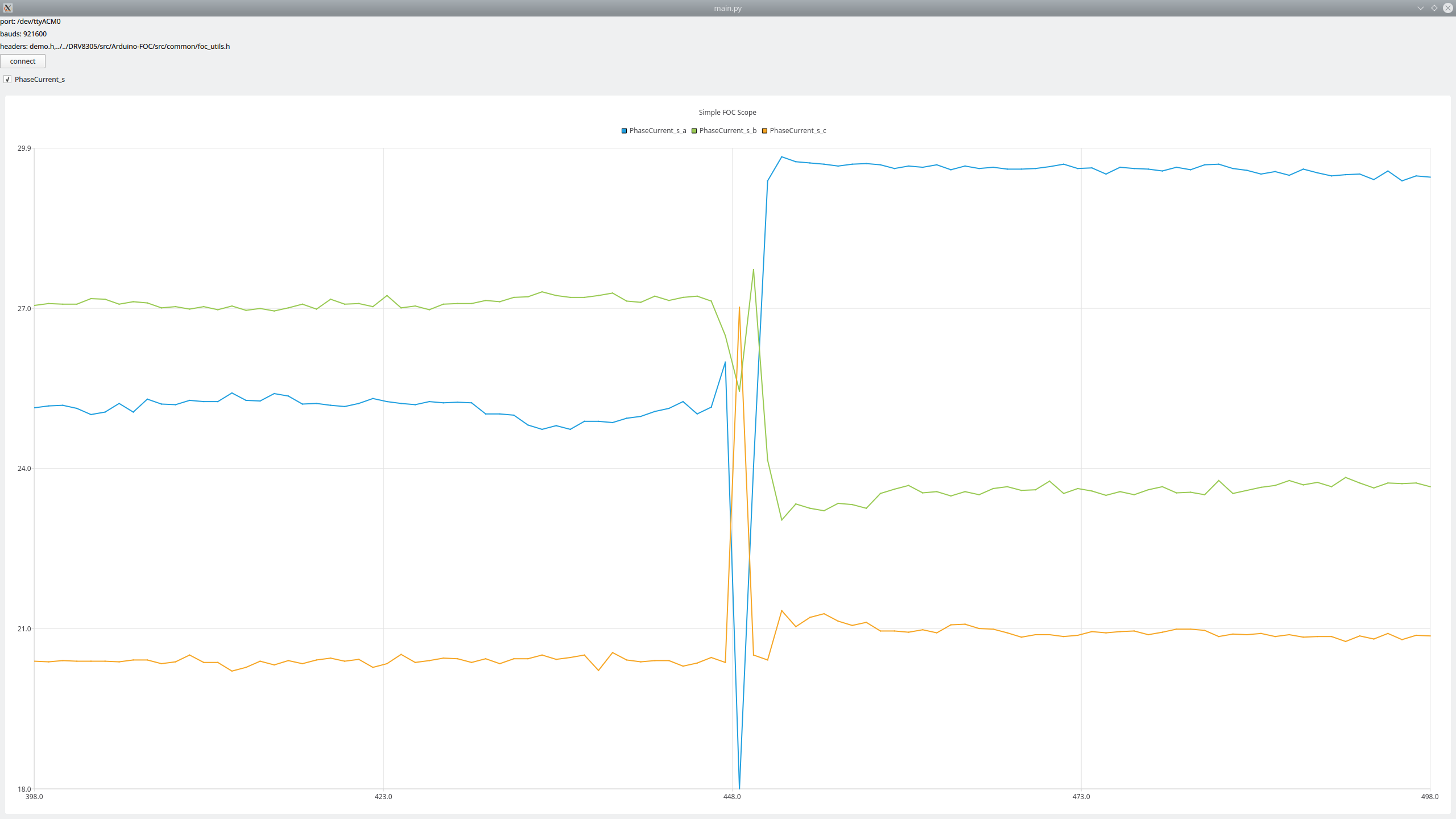

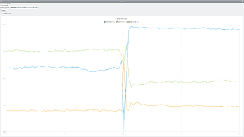

this is when I forfce my motor left and right.
