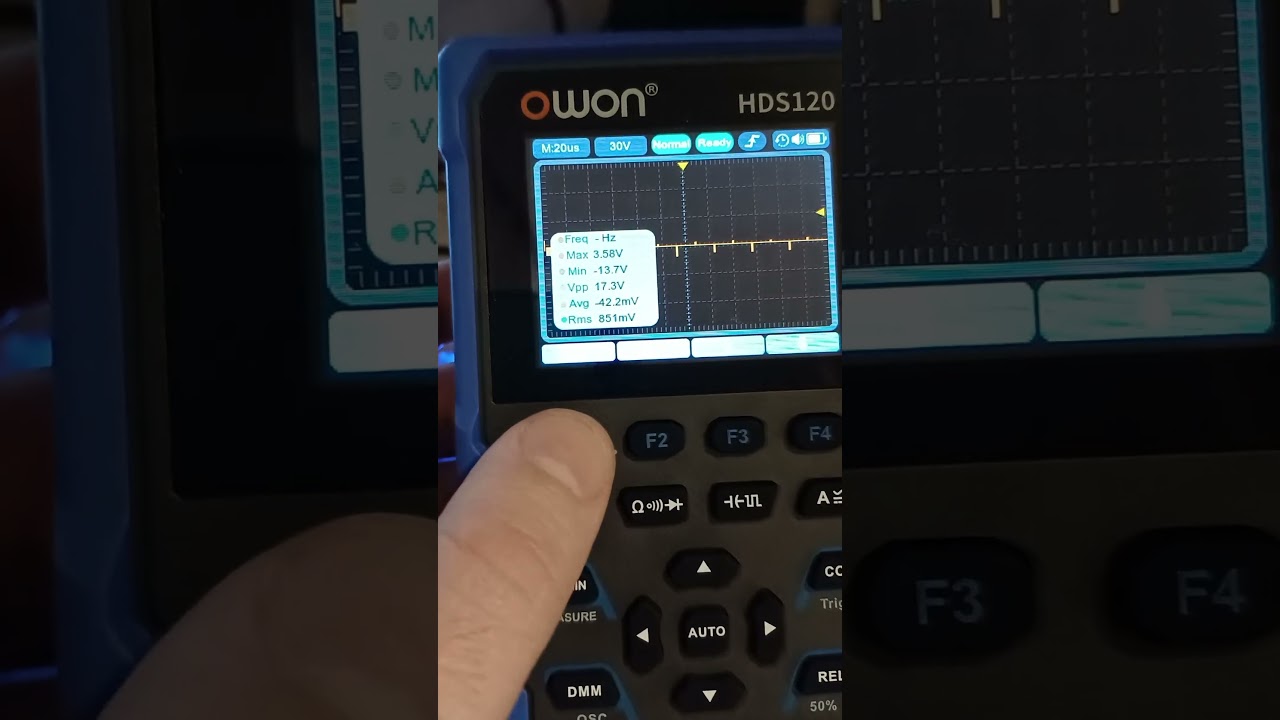

My understanding of what you describe as the sparkplug phenomena is basic induction. I have played with the transformers used to create ignition sparks. They are just transformers.
What happens is that if an inductor has current going through it, then you suddenly halt the current, the voltage will rise, depending on how fast the magnetic field around the inductor collapses, which depends on the core. If it’s air core, that’s the fastest of course, but it also results in a very low inductance for the same number of turns (iron is about 2000 times the permeabilty of air, so a coil with the same number of turns gets 2000 times the inductance).
In a boost converter they use this phenomena, watching the voltage rise and connecting the inductor to a capacitor at the right moment, as others have described here. It is still an active pumping method.
You could try to do this with the motor coils, but you need current to be flowing in the desired direction to begin with. Which is the reverse of what you have during normal drive. Also I’m not clear on how well it would work, you can only transform the energy that is stored in the inductor. This would entail forfeiting energy harvest from the rotor while you did this.
