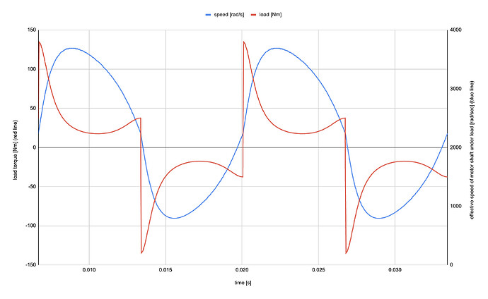

I am wondering if anyone has a recommendation of where to purchase/source a PMSM machine that:
  • is able to develop 30 Nm torque (continuous),
  • operating at a constant speed of about 2500 RPM (FOC controlled)
  • run off 48 V, and
  • be dual shaft (I need to mount an encoder on one end, Hall sensors won’t cut it)
The load profile, and effective speed (under load) of motor shaft during one rotation is attached here.
Looking forward to your thoughts, and suggestions.

Also, in my project the motor will need to flip-flop from generating to regen twice within a single revolution - see the speed/torque curves in the first post…Hence, what I really need is a battery.
