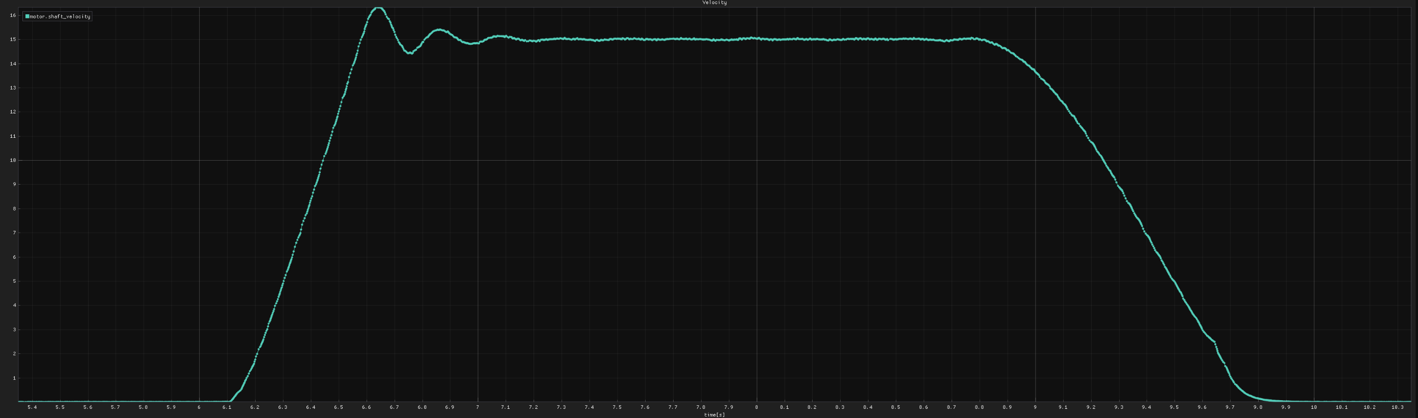

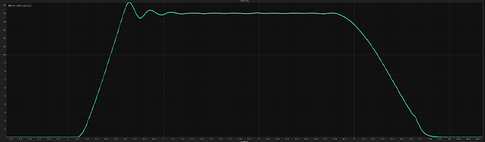

It’s not perfect but it works:
That’s still experimental.
