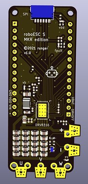

If you’d be interested in a SAMD21-compatible shield, I have made one that I am still in the process of testing, based on the new DRV8316 driver chip, KiCad files and gerbers are here:
It fits on top of / underneath an Arduino MKR type board like the MKR WiFi 1010 or MKR1000. The MKRs use SAMD21 MCUs.
If you want to help test it out, I’d be more than happy to send you one.

Wow, that’s a lot of caps! :slight_smile:
Did you miss the solder paste on the ground pad?
I guess they would have added this.
You’re not the first one to note that. :smile: Capacitance is a great mystery to me, the DRV8316 eval board from TI has even more, in the form of an electrolytic cap… I kind of modelled my choice on that, but since those are too big for my purposes I went with a bunch of ceramics. I think it is more than needed. You get a nice “afterglow” on the LEDs when you switch the power off :rofl:
Yup, good find! Fixed it. That’s the dangers of creating your own footprints.

I see that your board has pads instead of pin headers for the motor, so the DRV8316 is for high-performance motors? If so, that would work well for me, as the only motor I have right now is a 2207 1700kv drone motor.

It’s more of a lower end driver in terms of the power output, but its certainly high performance in terms of the features. It can do 3A continuous (with appropriate cooling) and 8A peaks. That is good for an integrated FET driver, but not much compared to what you can achieve with external FETs.
I guess it is designed to achieve higher integration for things that only need smallish motors. It’s cool because it completely integrates the current sensing without any external components. It’s certainly enough for a small drone, or RC-toy, camera gimbal or thing like that. It’s not enough for a race-drone, hoverboard or anything big.
